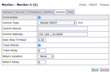

Hey guys. I have a slightly different PTZ camera, but I believe it to be from the same original manufacturer. Mine is branded as a "JideTech" and came from here: https://www.amazon.com/Outdoor-Security ... B074N2TRRR
After some trial and error with Wireshark, I have a working PTZ script based on the included Netcat script. It could use some cleanup, but I thought it would be useful to post here for now.
https://pastebin.com/tAgHvXSe
I'm using the following settings:
Screen Shot 2018-07-09 at 1.26.52 PM.png (32.21 KiB) Viewed 65568 times
I'm just messing around with the "Track Motion" setting. That doesn't need to be checked. I also haven't bothered to change the camera's username and password from the default admin:admin. They're on an isolated network so I don't have a need to.

@Epsilon187: I second the port suggestion. The "connection refused" error strongly suggests that the port is incorrect.
You should be able to use the control script I linked above. My cameras also use "onvif/ptz_service" to control the PTZ stuff. Though mine use port 8999, not sure what port is the correct one for yours.
The change to "onvif/ptz_service" was the biggest thing I had to do to get the script working. The original netcat script uses "onvif/device_service" but my cameras don't provide PTZ control at that URL.
I knew I was getting close when the cameras were responding with "400 Bad Request". instead of a connection refused error.

I used exactly the setting posted by starbucks:
viewtopic.php?f=36&t=25138&start=15#p106457
i.e.:
Control Type = Netcat ONVIF
(nothing for Control Device)
Control Address = 192.168.1.200:8999
Auto Stop Timeout = 2.00
and I modified the Netcat.pm as posted above.
