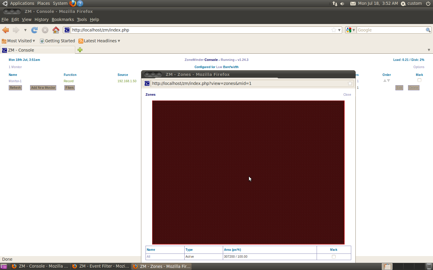

OK got this far:
OK got this far:
- Screenshot.png (128.04 KiB) Viewed 5812 times
Re: Zoneminder installed but what next?
Looks like you got it running. Be sure to search the forums for answers or read the Wiki; have fun.
Oh ok but i don't know why the preview is red. Is that a preview that i stumbled upon? I really don't know how to set anything or record or.....ok will have to try again another day as i was clicking away for too long. Gee i just thought of something. I would have to run all this stuff everytime i booted up the computer to record footage/use zoneminder. A bit tedious. Don't know what to to do now. It would be better that it is installed so i don't have to fluff around everytime

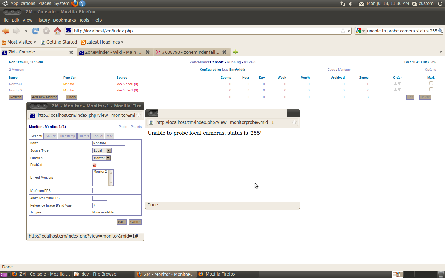

Unfortunately not getting any preview on the cameras now. I decided to try with my webcam that has never worked with the current version of linux that i have installed. I know it is working because it does with the windows machine. Does this error in the image attached mean that both cameras are not liked by zoneminder?

My fault! Install the LiveCD/ DVD to your drive, any configurations will then be permanent. I should warn you that installing to the machine will eliminate everything on that drive (wipe the hard drive clean) so be sure you don't need any of it before installing. Red source means bad configurations for cameras. Swore I saw green in an earlier post.

So what do you mean by red source...or bad configuration? Um i did see green after the red but that happened only yesterday and i didn't mention it. Now it is not green anymore. I was messing with all the things and it did happen. Unless i was tired and imagined it lol. The second camera(usb webcam) i got nothing from at all. Not even a window. So does this mean that zoneminder doesn't like these cameras?

I'm confused. Your first screen shot shows a working monitor configured as remote. Now I see not working configured as local... You will need to look at the capture card and post the capture chip type (pinnacle dc10plus used several over the years), also post a screen shot of your monitor source tab.
- Screenshot.png (128.04 KiB) Viewed 5769 times
Sorry i don't know what a working monitor is? Do you mean there was an actual image? There wasn't. Zoneminder has only given me whatever i said or posted here. I honestly don't understand much i am afraid. Oh so i would have to take the card out? Gee i have no time to do that. There is a lot of stuff in the way of getting the machine out plus my back is bad. I am afraid that will have to wait. What is the monitor source tab? Oh in zoneminder. OK will have to do that another time too as it is late and there is a lot i can't do with the livedvd in the computer.

You need a working zoneminder installation before you can get it working in MythTV.
Does the user that's running the zoneminder services have permission to access /dev/video0? Usually this means whatever user is running zoneminder services has to be a member of the "video" group. On my system that user is www-data. Look in /etc/group to find out.
Also, syslog probably has some useful logging that might indicate what zoneminder is having problems with.
