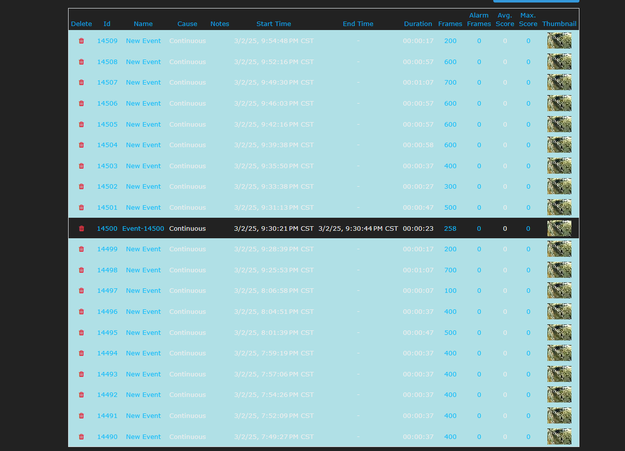

Hi all,
ZM Version: 1.36.33
Linux zoneminder 6.1.0-31-amd64 #1 SMP PREEMPT_DYNAMIC Debian 6.1.128-1 (2025-02-07)
I've been working on getting emails sent out for alarmed events, and in the process changed some things that have caused for events to not properly have end dates. They also all end in a 7 for the seconds, not sure if that matters or not. But all events are still able to be played back.
I currently only have 1 camera/monitor on the server. Storage is an NFS share hosted on a Truenas bare metal PC. I did slight tweaking on the Truenas box, but it was for SMB share not NFS, so shouldn't have affected this. I'm normally methodical about changing 1 thing at a time to see what needs to be reversed if needed.. but got too cocky I suppose.
I'll post logs with full debug and event lengths, along with some other settings. Appreciate any assistance, I'll keep working on my end. Let me know if any more info is needed.
It was working for quite a while before I went around and messed things up.. so should be fixable.

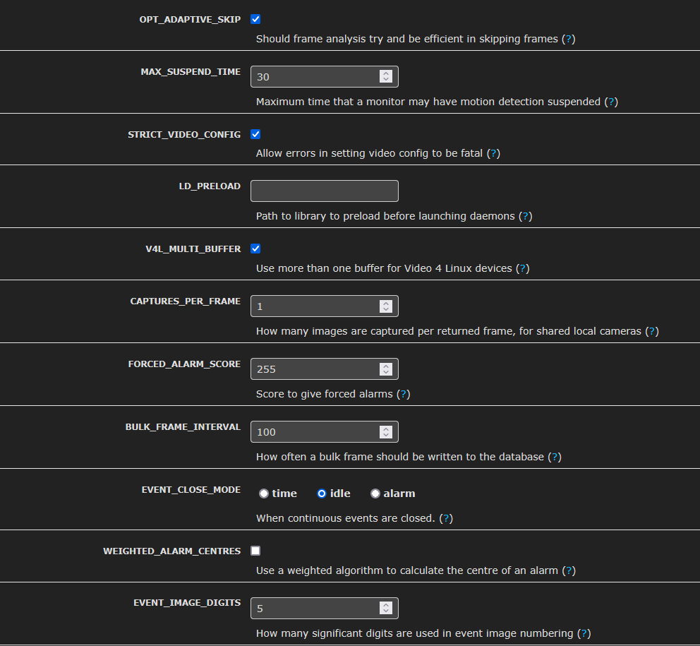

Events and Options attachments
- events.png (182.11 KiB) Viewed 28389 times
- SystemSettings.png (39.37 KiB) Viewed 28389 times
- ConfigSettings.png (40.12 KiB) Viewed 28389 times

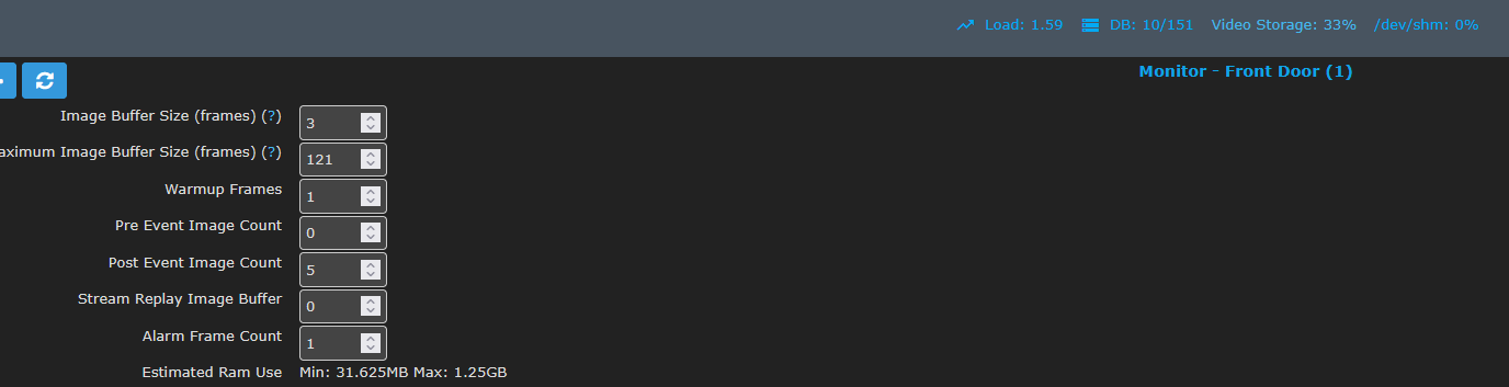

Monitor Settings
- Buffer.png (14.11 KiB) Viewed 28389 times
- MonitorStorage.png (12.32 KiB) Viewed 28389 times

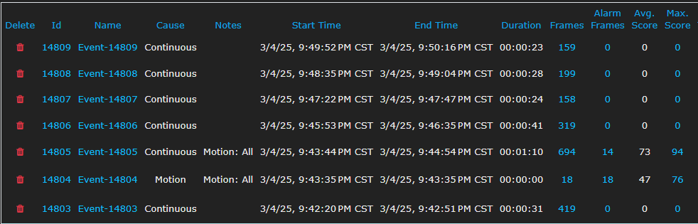

Re: Events with no EndDate, awkward lengths too
I reduced the buffers by advice of another post... and now the issue seems worse. And analysis seems to be at 0 fps with load being much higher than expected. Watching the camera from it's web config the stream is consistent and fine. However in zoneminder it loses connection repeatedly and restarts itself.
SSHing into zoneminder is also slow to respond when typing, and browsing the logs is quite slow now too at times. Entire zoneminder VM might be hitching?
- Screenshot_3.png (16.95 KiB) Viewed 28177 times
- tableExport(5).txt
- (59.68 KiB) Downloaded 199 times

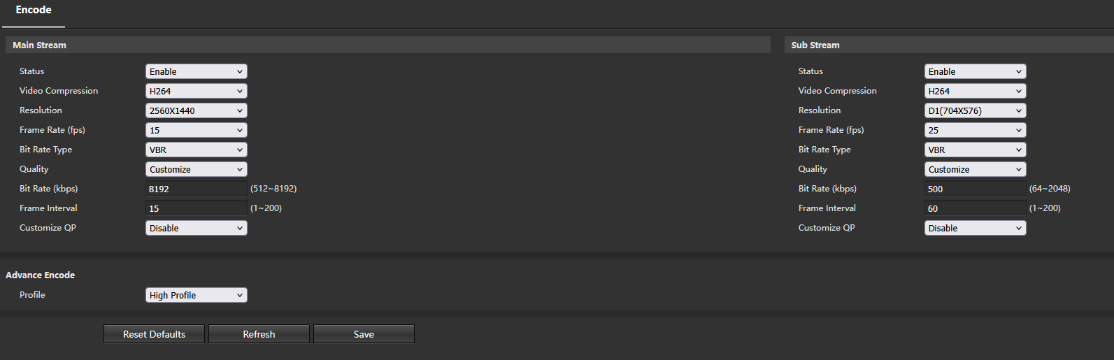

Still getting intermitent connection. I even doubled the CPU cores to 8 and it is not even struggling... Events look like they're ending properly now though, that is most likely due to the version upgrade I would assume. They should be 5mins in length in Mocord/Record.
- Screenshot_5.png (27.65 KiB) Viewed 27295 times
- tableExport(8).txt
- (59.48 KiB) Downloaded 228 times
- Screenshot_4.png (3.13 KiB) Viewed 27297 times

I've attached buffer settings and the camera's webconfig settings, feel like there is some mismatch here but not sure what just yet.
Bought a new camera, set it up, and am getting lots of these errors:
3/11/25, 6:30:06 PM CDT zmc_m1 1745 WAR Found locked packet when trying to free up video packets. This means that decoding is not keeping up. zm_packetqueue.cpp 173
3/11/25, 6:30:06 PM CDT zmc_m1 1745 WAR You have set the max video packets in the queue to 121. The queue is full. Either Analysis is not keeping up or your camera's keyframe interval 43 is larger than this setting. zm_packetqueue.cpp 153
The implication is obvious, however I don't see how or why it decoding is so slow? Almost 0 computer load, 1 2560x1440p camera set to Mocord, on a blank still image of my basement ceiling for testing... They are crappy anpviz cameras off amazon, but I've never had these kinds of issues, so a bit confused what might be the issue.
I suppose I could set up a lower res monitor using substream and use motion detection on that. Not ideal cause I am trying to send email jpegs of events. So I'd have to link the low res to start event on high res? And send email from that monitor? That has a lot of downsides. But I feel like this should be capable of modect on 1 1440p monitor on quite modern hardware...

I've changed camera to Encode 264, 265, 265+, no change. I've set 265 on camera webgui settings, no change.
Setting the camera as Passthrough helped a decent chunk, still get the same errors about every 5 mins though (also filter 5 seems to be buggin dunno why but ignore the errors):
