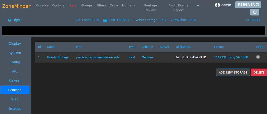

Thanks for the responses... I just came back to check and sounds like that is what I should do rather than build a new system. I think if I just add another storage disk and format it, then it should show up in ZM right? I can just switch each camera to the new storage? What will happen with the old events will they continue to work and go to the old storage? I can then remove it after the retention policy (filter I setup to delete events older than x days) has cleared out all the video.
This is the dedicated storage I have for it... so I presume if I just add another disk, format it, and mount it with the same path it will show up in here? Can I give it the same path? There would be two different mounts for two different UUID's.

Re: Import of monitors fails
I'm not sure zm would understand that.
I know you can mount at /var/cache/zoneminder/events? where ? is a number or anything you want.
But it won't "show up" there - you need to specify the path to the new storage. You can do that either before or after you mount the device.
If you mount the new disk at the same point as the old disk the old events will become inaccessible or Linux will not allow the mount because the directory is not empty. If you change the path to the old events ZM will no longer know where they are located and they will show as inaccessible.
