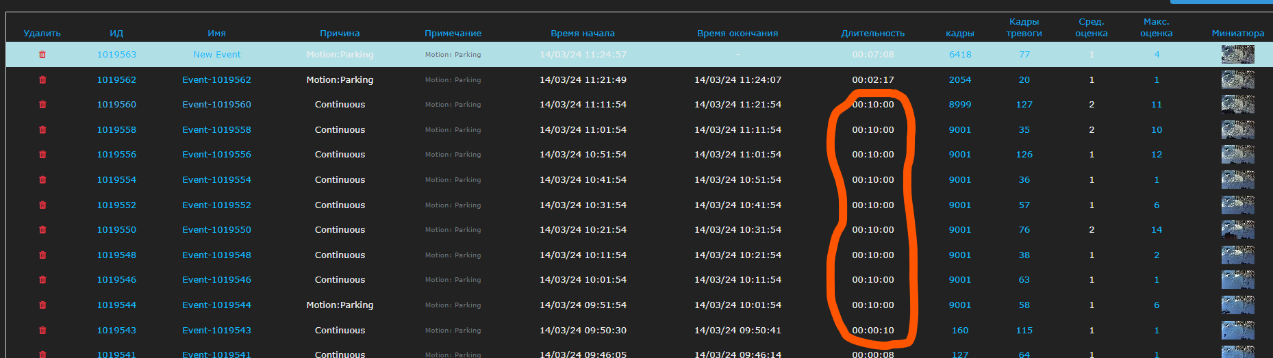

1.37.55~20240313084849-jammy not stop record after move detection out.
Снимок экрана 2024-03-14 113232.png (147.23 KiB) Viewed 1647 times

i'm in mocord - I guess this also explains all my cams stay in alarm/red highlight....montage view.

Same problem here with zoneminder_1.37.55~20240313.153-bookworm_amd64
Once motion is detected it keeps on recording even if the trigger event is gone. Alarm remains on (red frame). Setting is OnMotion.

After my update yesterday, same thing, the recording starts with a detection and doesn't stop. It is cut into 5-minute segments
edit:
The cause ? https://github.com/ZoneMinder/zoneminde ... 5dae3a42b5
