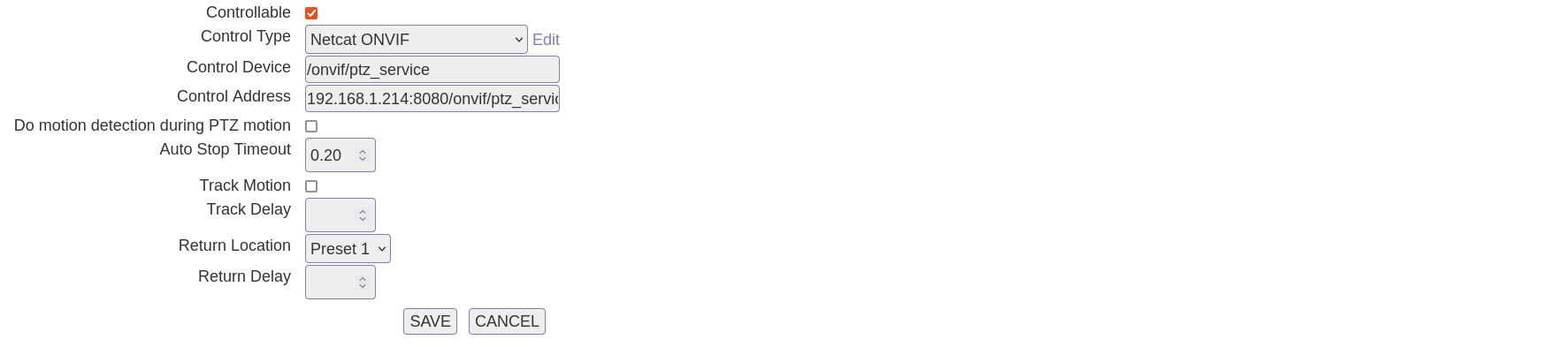

Try setting Monitor->Control->Auto Stop Timeout to .2 or so, if you haven't.

hmmm. Does look something like this?
You might be using the wrong script - there's the one I've got there and "ONVIF Camera" are probably the first ones to try, then it's a crapshoot, I'm afraid.Re: PTZ Control of Topcony camera.
Thanks for the reply, before I saw this I'd found an older post about a Bogasen canera and copied those settings, this stops the camera moving, but presets still dont work.
The settings are identical to the ones in your image (thank you).
