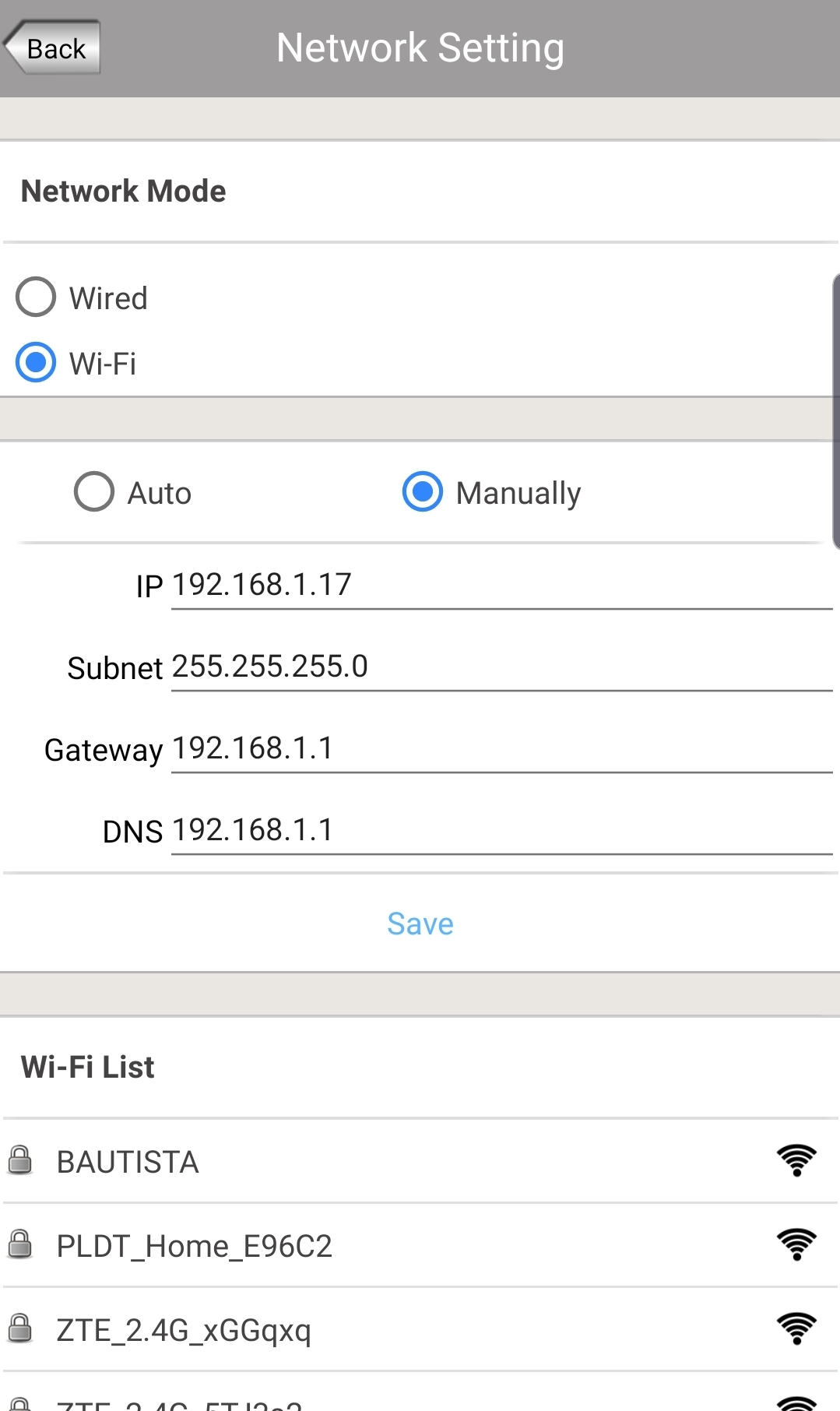

Re: Setting static IP-address for Sricam SH0024
You need to dowmload the srican software from android store or the factory tool from their download website
Anyway where's the problem with the app android you programming eady any static ip
The picture is a example connected to a nanostation n2 wired to a unifi gateway
- Screenshot_20200817-220608_Sricam.jpg (198.64 KiB) Viewed 11530 times
