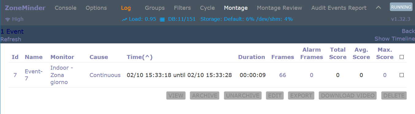

I receive:
It seems my ZM 1.33 (or 1.32) is able to view the live MJPEG stream, but not able to view the same stream when recorded .

Note: in log console i receive the following warning when I record:
and the following error when I try to view what recorded;
the result is the following screen:
Can't find process with command of 'zma -m 2'
getCmdResponse stream error: Socket /var/run/zm/zms-436737s.sock does not exist. This file is created by zms, and since it does not exist, either zms did not run, or zms exited early. Please check your zms logs and ensure that CGI is enabled in apache and check that the PATH_ZMS is set correctly. Make sure that ZM is actually recording. If you are trying to view a live stream and the capture process (zmc) is not running then zms will exit. Please go to http://zoneminder.readthedocs.io/en/latest/faq.html#why-can-t-i-see-streamed-images-when-i-can-see-stills-in-the-zone-window-etc for more information. - checkStreamForErrors()

The issue is that it's not possible to reproduce a video from the recorded JPEGs. It was possible with ZM 1.29 and ZM 1.30.4. I see only a fixed frame (probably the first) or nothing on ZM 1.32 or 1.33.
On lower ZM versions like 1.29 or 1.30.4, ZM is able to reproduce a video using the recorded JPEG images.
In log file I'm getting the following ERR message:
Socket /var/run/zm/zms-973978s.sock does not exist. This file is created by zms, and since it does not exist, either zms did not run, or zms exited early. Please check your zms logs and ensure that CGI is enabled in apache and check that the PATH_ZMS is set correctly. Make sure that ZM is actually recording. If you are trying to view a live stream and the capture process (zmc) is not running then zms will exit. Please go to http://zoneminder.readthedocs.io/en/lat ... window-etc for more information.

I edited apache error log with sudo nano /var/log/apache2/error.log.
That's the result:
Mode: Replay Rate: 0x Progress: NaN:NaN:NaNs Zoom: 0x
So, probably we are stupid users not able to debug the error, but for sure we are many and following exactly the istruction on Zoneminder site.
That's the result:
the log seems ok also after trying to open a recorded mjpeg image and the image is blocked at the first frame and it appear the following message under the image:[Sat Apr 20 14:48:53.294943 2019] [mpm_prefork:notice] [pid 833] AH00163: Apache/2.4.29 (Ubuntu) configured -- resuming normal operations
[Sat Apr 20 14:48:53.296879 2019] [core:notice] [pid 833] AH00094: Command line: '/usr/sbin/apache2'
