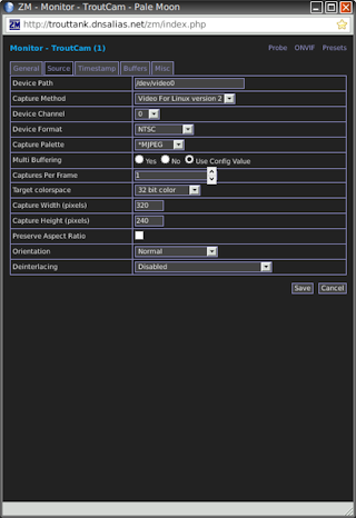

I use a similar camera to stream a aquarium of trout raised from eggs 24/7 for the last 6 years. at the moment it is running off a very old 2002 Dell laptop with 512 megs of RAM.....using Puppy Linux Xenial (Ubuntu 16.04 binaries) and zoneminder 1.30.4 stable......these are my settings at the moment..with a frame rate of 5 (low RAM)
I have not yet really done much experimenting with the settings. Buffers are set to the defaults.
