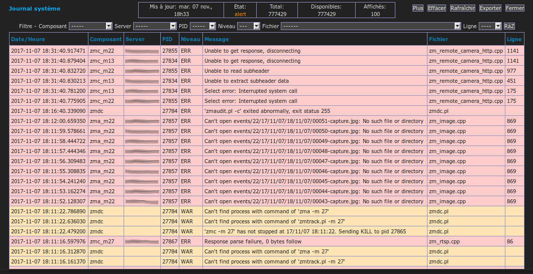

Re: [problem] Zoneminder several crash
Post by vox »
This post receive edit during the day.
Logs after a crash with 2 cams (1 in Modect and 1 in Mocord). On my last ZM install this config don't have this bug.
screenshot-2017_11_08-ZoneMinder-Logs-Crash_at_15h03_With_1cam_Modect_and_1cam_Mocord.png
screenshot-2017_11_08-ZoneMinder-Logs-Crash_at_15h03_With_1cam_Modect_and_1cam_Mocord.png (76.01 KiB) Viewed 10148 times
With this config (1 cam modect + 1 cam mocord) the bug is not solved
