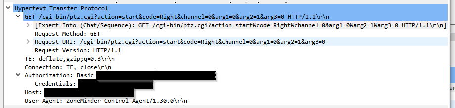

So I was actually working on modifying my own script for this, and was running into a problem with a 401 Authorization Error when I was attempting the GET call from the Perl Module.
In Googling to try to figure this out, I came across this script, and I figured I would download it and give it a shot. Exact same issue. The odd part is if I copy the URL call out of the Info Logs in ZoneMinder and put this directly in a WebBrowser I get an OK code back with no 401 Issue.
This was a Brand New Camera, so I updated it to the latest Firmware that was released on 3/22/2017 before attempting to work with the scripts. This is the Version Data off the Camera:
Software Version
2.420.AC00.17.R, Build Date: 2017-03-22
WEB Version
3.2.1.434383
ONVIF Version
2.42
This is the log that this script creates for a move Right:
Camera control command FAILED: '401 Unauthorized' for URL user:password@10.10.10.92/cgi-bin/ptz.cgi?action=start&code=Right&channel=0&arg1=0&arg2=1&arg3=0
If I copy this out, add http:// to the front of it and paste it back into chrome, the motion starts with no issue.
So was hoping I could verify with someone who has this working what software version they are running and if they are experiencing the same issue, I am hoping but also not hoping that it is a Firmware issue and Not a ZoneMinder Issue.

Gilley7997 wrote:This is the log that this script creates for a move Right:
Camera control command FAILED: '401 Unauthorized' for URL user:password@10.10.10.92/cgi-bin/ptz.cgi?action=stop&code=Right&channel=0&arg1=0&arg2=1&arg3=0
How can that be, you are telling the camera to STOP motion, not start?!? If the URL had "action=start" then perhaps, but with it directing a stop, something else is wrong.
Is the code actually sending the HTTP:// or HTTPS://, a correctly formatted get (it may be a PUT, I can't recall from memory)? If its only sending the string you have quoted, then that may be the problem.
I would grab a copy of wireshark and look at what is actually being sent to the camera by the code. That should tell you what the camera is actually receiving. If its actually sending the correct protocol and text, then you have got something else wrong.
PS, you dont want to be doing what you are doing over http of course, your login/pw are in the clear. If its going from your ZM node on your LAN to your camera on your LAN and never leaving the LAN, then its OK. But its bad practice anyway.
Gilley7997
Posts: 6
Joined: Sun Apr 02, 2017 5:36 pm
Re: Amcrest PTZ functionality
Post by Gilley7997 »
You got to this before I had a chance to edit it. Your code calls both functions in the same call (as did mine), and I just copy and pasted the last log error, it actually fails the same way for both the start and stop action.
That is the direct code from your Module not mine, and it is using http, and I agree with you that definitely shouldn't ever leave my LAN, and it does not,
It is actually isolated on a specific segment of my LAN at home.
I had not changed the Module you created in ANY way, but I am receiving this error. Have you tested this lately on a Amcrest CAM. If so what Firmware is it using? Thanks for replying, just can't understand why out of the Zoneminder call, it's unauthorized, but from a Webbrowser it's fine.
I have gone over both your code and my own and can't find where the issue would lie in the code itself, so I was wondering if anyone was running this on this latest firmware as well.
This is the relevant line of code that sets the command and sends the commmand and also generates the log.
    #section of code that formats the API Call
    $self->sendCmd( 'cgi-bin/ptz.cgi?action=start&code=Right&channel=0&arg1=0&arg2=1&arg3=0' );
    usleep (500);
    $self->sendCmd( 'cgi-bin/ptz.cgi?action=stop&code=Right&channel=0&arg1=0&arg2=1&arg3=0' );
    #relevant section from sendCmd Function:
    my $req = HTTP::Request->new( GET=>"http://".$self->{Monitor}->{ControlAddress}."/$cmd" );
    my $res = $self->{ua}->request($req);
    #Section that is generating the log entry I pasted above:
     if ( $res->is_success )
        $result = !undef;
        # Command to camera appears successful, write Info item to log
        Info( "Camera control: '".$res->status_line()."' for URL ".$self->{Monitor}->{ControlAddress}."/$cmd" );
    else
        Error( "Camera control command FAILED: '".$res->status_line()."' for URL ".$self->{Monitor}->{ControlAddress}."/$cmd" );
This is the dump from wireshark, the credentials were correct prior to being blacked out as well as the host name and port. The camera is listenting and responding as the very next packet is the acknowledgement and then the returned 401 Unauthorized message
