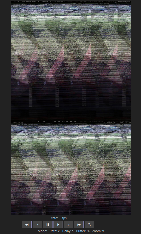

I just upgraded to 1.35.5~20200714143209-bionic and some things are broken. I can get video from most of my cameras, but my camera that is rotated 90 degrees shows mostly misplaced scan lines with an occasional flash of the non-rotated image.

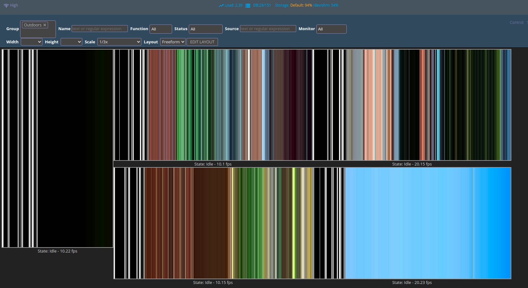

The montage on the web interface and on ZmNinja is broken for all cameras. All monitors show some version of vertical stripes.
I was able to get back to normal by downgrading to 1.35.5~20200617125058-bionic.
Anyone else?
Screenshot from 2020-07-14 15-58-06.png (52.89 KiB) Viewed 3664 times
Screenshot from 2020-07-14 15-57-45.png (975.73 KiB) Viewed 3664 times

On focal (20.04) it looks like a scaling problem.
At "Actual" looks OK. Anything else is like yours.
edit: not exactly like yours, but messed up vertical. Not like the fuzzy ones.
Interestingly, "scale to fit" is also OK.

Same bug on 18.04 after update 1.35.5 apt update
when scale active image strange
scale 100% is ok on zmninja but less than 100 bug

Same problem here. Only the montage view has the lines, when I click on a camera the full screen looks fine, both on the web interface and on zmNinja. I may try the downgrade.

Traveler21, does "scale to fit" not look OK n your system? Which is what, BTW?
Posts: 1377
Re: Rotated camera, montage and ZmNinja broken after upgrade
I see a new 1.35 That fixes the displays, for me.
