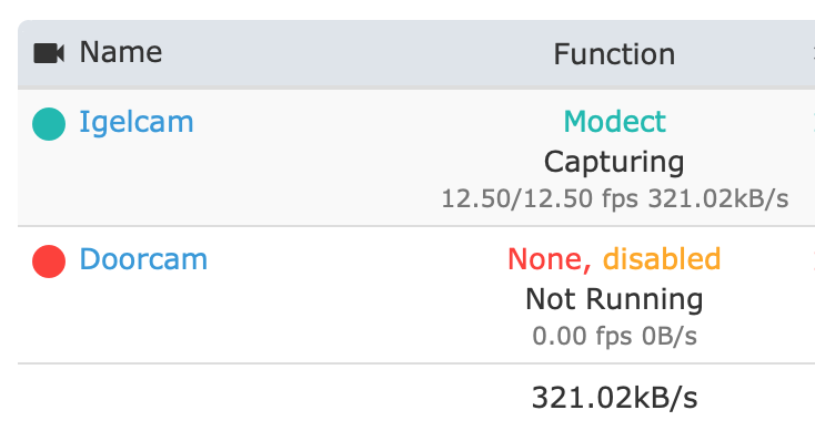

Hi Burger,
thanks a lot for the explanation. I tried to validate what's in the db -- but it seems the database doesn't reflect the state I enter. It is right now enabled, but not in "mocord" from what I see in the db.
That's what I get:
At the same time, what I see in the interface (I switched to mocord and enabled the "Igelcam") is this (see attached screenshot).
Do you have any idea why my zm might not be saving the data correctly? Otherwise the db works fine, events are saved, etc..
That's what I get:
MariaDB [zm]> select * from States
| Id | Name | Definition | IsActive |
| 1 | default | | 0 |
| 2 | Daytime | 1:None:0 | 0 |
| 3 | Nighttime | 1:None:0 | 1 |
3 rows in set (0.000 sec)
MariaDB [zm]>
Best
Hendrik

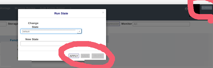

Re: Camera Function (modect etc) back to "off" after changing state.
Steps to save a runstate (assuming it is working):
1. Change cameras to reflect the mode you want them to be in
2. Click the 'running' icon in the top right
3. Type a name for the runstate and click save. If you already have a run state with that name, type it anyways. It will overwrite the old entry.
If you already have mode settings, you can apply, make monitor changes, and then type the name and hit save.
You could argue that it should allow you to select the old entry from the drop down and click save, but in my 1.34 it doesn't seem to work that way (not sure about 1.36). It must be typed. It's a minor concern, and probably not worth asking the developer's to fix. Anyways it works more or less.
- runstate_save_locations.png (13.9 KiB) Viewed 1705 times
Awesome, this solved my problem! Thank you very much! Indeed I just did not understand the UI.
