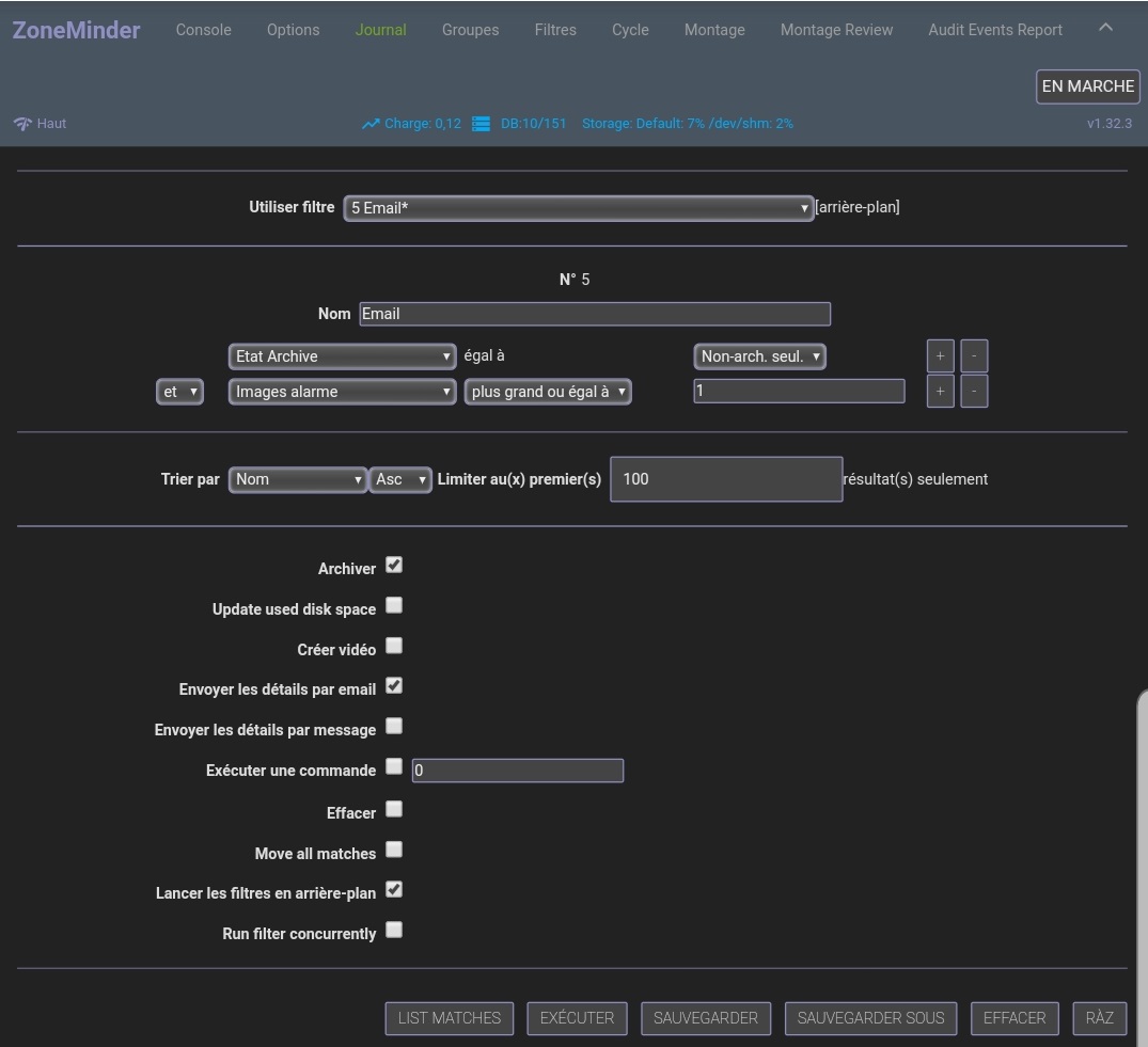

I peeled the whole forum, I managed to install zoneminder on ubuntu , to set everything I wanted :)
I want to thank everyone for sharing and helping.
I created a filter that sent me my detections of movement by email. the problem is the script does not turn into a background spot ...
I have to run to be warned ... so utility is less ...
do you have another filter on event creation can be?
I would like not to see to install script .. use the functions of ZM for ease future maintenance.
Thank you for your help

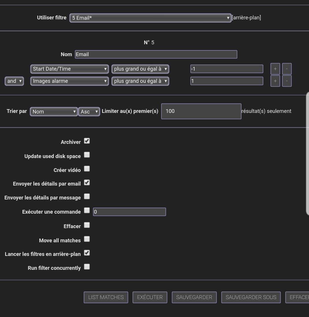

so I used:
date / time greater than or equal to -1 minute AND
alarm frames greather than or equal to 1
as I wish to watch every day!
I try this new configuration and come back to you
nonobike
Joined: Thu Aug 22, 2019 6:17 am
Re: Email ZM1.32.3
Post by nonobike »
It does not work ...
The criteria of my old filter are valid. when I manually execute it I receive the alarms! How can I verify that it turns out well in the background?
Thank you
