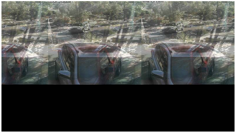

Without changing any settings, the night before, the output was fine. This morning, the image looks like this.
I rebooted the server and still the same output.
The camera is a very basic IP camera, reached by going to http://192.168.12.241:8080/?action=stream on a browser. Using any browser, the image (video frames) is fine. All is working. But, through ZM, I get the above.
My settings are;
General
Source Type: Remote
Function: Monitor
MFPS are empty as per someone's suggestion on github.
Alarm FPS same as above.
Source
Protocol: HTTP
Method: Simple
Host name: acadmin:1234@192.168.1.241
Port: 8080
Path: /?action=stream
Then the rest other than specifying resolution are default. What could have changed overnight that would cause this? I would have thought this kind of look was phase shift in old TV's only :).

Although you've changed nothing, you've not said what resolution the camera is supposed to be returning, vs the resolution you've set in Zoneminder
It looks like the camera is delivering fewer pixels per line than you are telling ZM to interpret.
Measuring off your PNG in GIMP, I make it about 320 pixels across per repeat (or 640, depending on whether I've slipped a line), but your image is 800 pixels wide.
Your camera is sending 320/640?? and Zoneminder is set for 800x?? or something like that. Otherwise, it looks like a perfectly good colour picture.

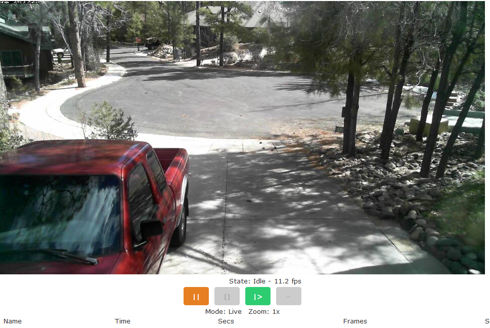

It should look more like this ... ?

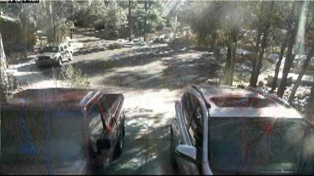

At the time of the image, the camera was set to 1600x900 and so was ZM.
However, now that I'm playing with it again, here is what I've discovered.
When using what might be considered odd resolutions such as 1600x900 (odd to ZM I guess), I get the kind of image I showed.
Changing the resolution in the GUI before changing them on the camera also crashes ZM completely. I've tried restarting it from
the CLI only to find that I have to fully reboot. No idea what's causing this.
Now I have it set to 1280x960 which is working but there is a black bottom to the image now. I then changed it to 1920x1080 and it works just fine without a black section at the bottom. I'd like a smaller image since I don't need 1920x1080 in this case.
This is how things look now.
So, the problem seems to be related to certain resolutions.
No idea why ZM is crashing however.

BobLaske wrote: Mon Mar 18, 2019 5:44 pm I like how you broke things down and how you 'fixed' the image :).
How did you do that?
GIMP, De-interlace filter (although the picture isn't interlaced, it gets rid of every other line which clears up most of the mess). Then re-scale to 16:9 aspect (as everything looks thin at 4:3 -- unlike ZM I am prepared to guess at your resolution and camera settings :).
