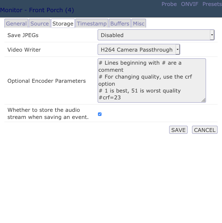

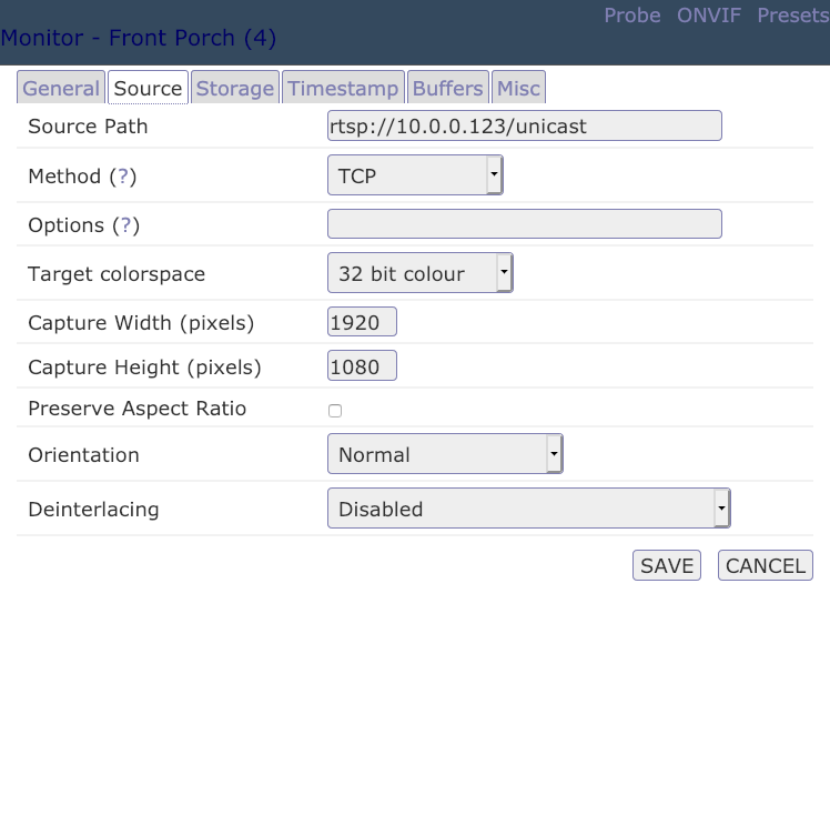

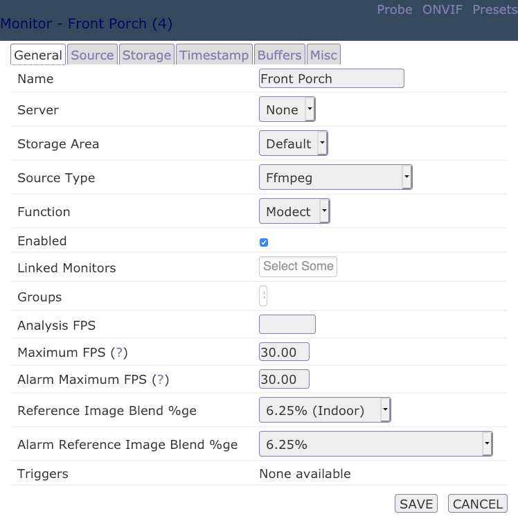

The Zoneminder issue is intermittent — yesterday I had 2 of the same cameras functioning fine but saw the same issue occurring when adding a third camera. Now today, I can't get a single camera to stream correctly; I disabled the other cameras when trying to debug this issue.
Cameras are cheap Xiaofang cameras (ZM monitor config screenshots attached), but the cameras stream fine via RTSP on the network — ffmpeg streams/records to a file for hours on end without error; I tested this on the same machine as Zoneminder to ensure there's nothing odd about the network configuration. Likewise VLC plays the streams without issue from another computer. For note, the post-event image count is up at 50 because of the "empty H264" files issue (viewtopic.php?p=107703); without it this high the result is events (when capture was working) would be empty video files.
Cameras are being streamed at 1080p and 25fps but it's worth noting the same issues were seen when dropping the resolution to 720p and 10fps. Other posts suggest RAM issues or availability of tmpfs or shared memory; there's sufficient RAM on the machine and plenty available (eg writing 8GB to /tmp works fine). For note, both ZM_PATH_MAP and ZM_PATH_SWAP are on separate tmpfs mounts.
Let me know if there's any other info I can provide, options I can tweak or tests to run. As mentioned, I'd tried tweaking WATCH_MAX_DELAY and also WATCH_CHECK_INTERVAL without any difference, tried tweaking the camera's internal settings for FPS/resolution, but also Zoneminder's monitor settings for storage, buffers and even Source Type (eg tried as "Remote" but that fails entirely with 400 Bad Request, as expected as it is deprecated/non-recommended to use this).

Pedulla wrote: Wed Feb 06, 2019 4:25 am Also try the straight H264 encoding rather than passthrough and see if you get different results.
Some of my cheap chinese hikvision cams just won't do h264 passthrough.
I had tried this but the reason I couldn't use it was because of this issue where ZM produces H264 files that are empty (viewtopic.php?f=38&t=27916). Changing the cameras over from Passthrough to X264 again now shows the same issue but the capture processes are staying up and running (30 mins and stable). Events get registered and displayed but their content is empty, because the aforementioned issue. This might be an option, if that other issue can be fixed.
What's ZM doing differently between Video Writers that prevents H264 Passthrough from working? My cameras are sending H264 video, which seems to match what the docs say. Here's output from manual ffmpeg:
Input #0, rtsp, from 'rtsp://10.0.0.123/unicast':
  Metadata:
    title           : LIVE555 Streaming Media v2014.07.04
    comment         : LIVE555 Streaming Media v2014.07.04
  Duration: N/A, start: 0.000750, bitrate: N/A
    Stream #0:0: Video: h264 (High), yuv420p(progressive), 1920x1080, 90k tbr, 90k tbn, 180k tbc
    Stream #0:1: Audio: pcm_alaw, 8000 Hz, mono, s16, 64 kb/s
And the dimensions are definitely set correctly in my Monitor settings. Looking at the Github issue tracker, there's some various bugs about Passthrough failing with certain formats etc -- perhaps something along those lines?

Remove the 30 from Max FPS and Alarm Max FPS. They aren't needed anymore and I've seen some cases where zm was trying to satisfy the 30fps requirement and starving the ffmpeg libs for CPU time.

iconnor wrote: Thu Feb 07, 2019 3:20 pm Remove the 30 from Max FPS and Alarm Max FPS. They aren't needed anymore and I've seen some cases where zm was trying to satisfy the 30fps requirement and starving the ffmpeg libs for CPU time.
Isaac
Wow, yep that looks like the issue -- thank you!! Instantly sees all monitors now capturing correctly with the right frame rates and with audio included (with H264 Passthrough set). H264 files are saved to disk correctly.
These two fields were set at 30 FPS by default when I added the monitors so I'll make a note to always clear them out in future -- are they being removed or blanked by default in future versions?
