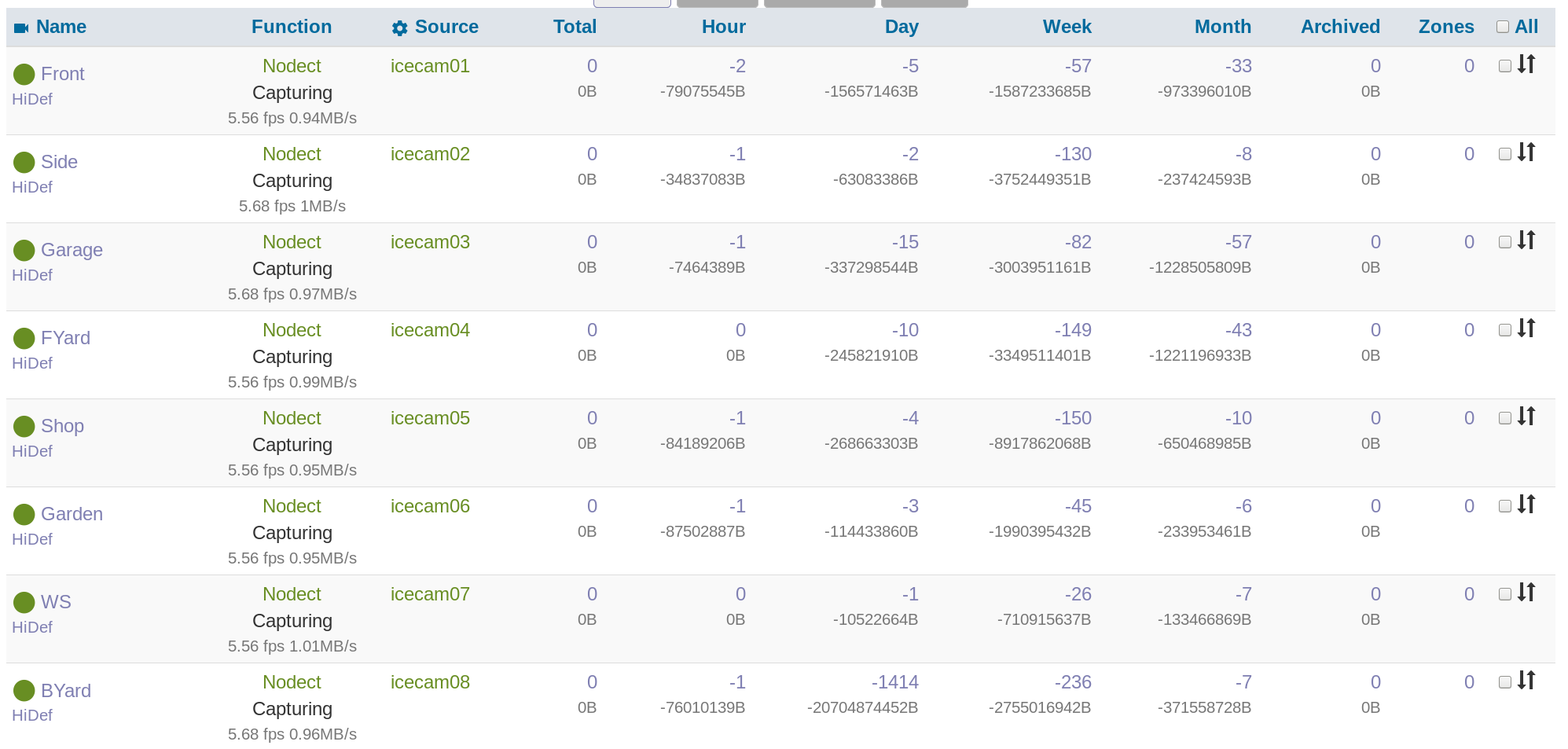

After getting 1.32.3 to run correctly I purged quite a few events to clean up some disk space. Everything seems to be working but I'm seeing some odd numbers in the console.
I used the command line and API calls to delete the events and then ran zmaudit.pl when I had purged everything.
Re: Update to 1.32.3 error
Yeah, I've seen that too on one machine, but not others. I am not sure yet how that happens, but the negative numbers go away as soon as a new event is recorded. Let me know if that holds true for your system.
Oh, and note that it appears to just be cosmetic.

I just read the thread in the 1.33.x area about what sounds like the same issue. I've forced an alert on one camera and that does not seem to clear things up. I did observe that my event ID's got reset to 1 somewhere along the way, they had been up in the 34xxx range before. I'll give a few hours and check back to see if it rights itself.

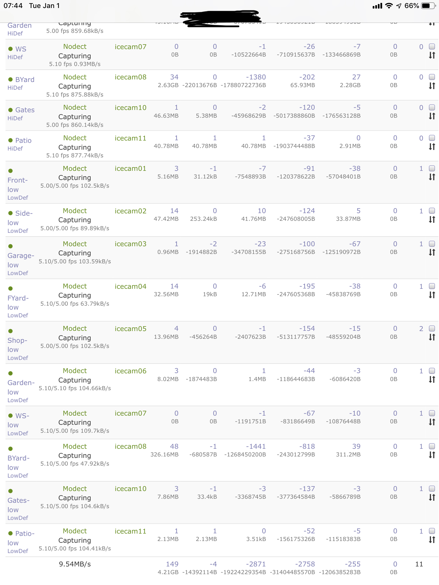

Still seeing negative event counts in the console. Everything seems to be working normally at least.

doesn’t seem to change the behavior though. Still got the negative event counts in the console. I did run it while ZM was stopped. Also forced an event on a couple of the low def monitors which results in two events since each high def monitor is linked to it’s low def version. The events get recorded as expected and deleting them goes normally.
Still have the negative counts but currently zero events in reality.
