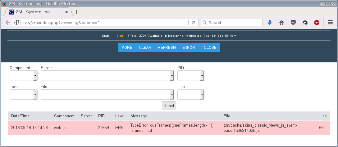

The log does produce a weird error on playback:
which I really don't understand. Something to do with the way I'm calling ffmpeg?
