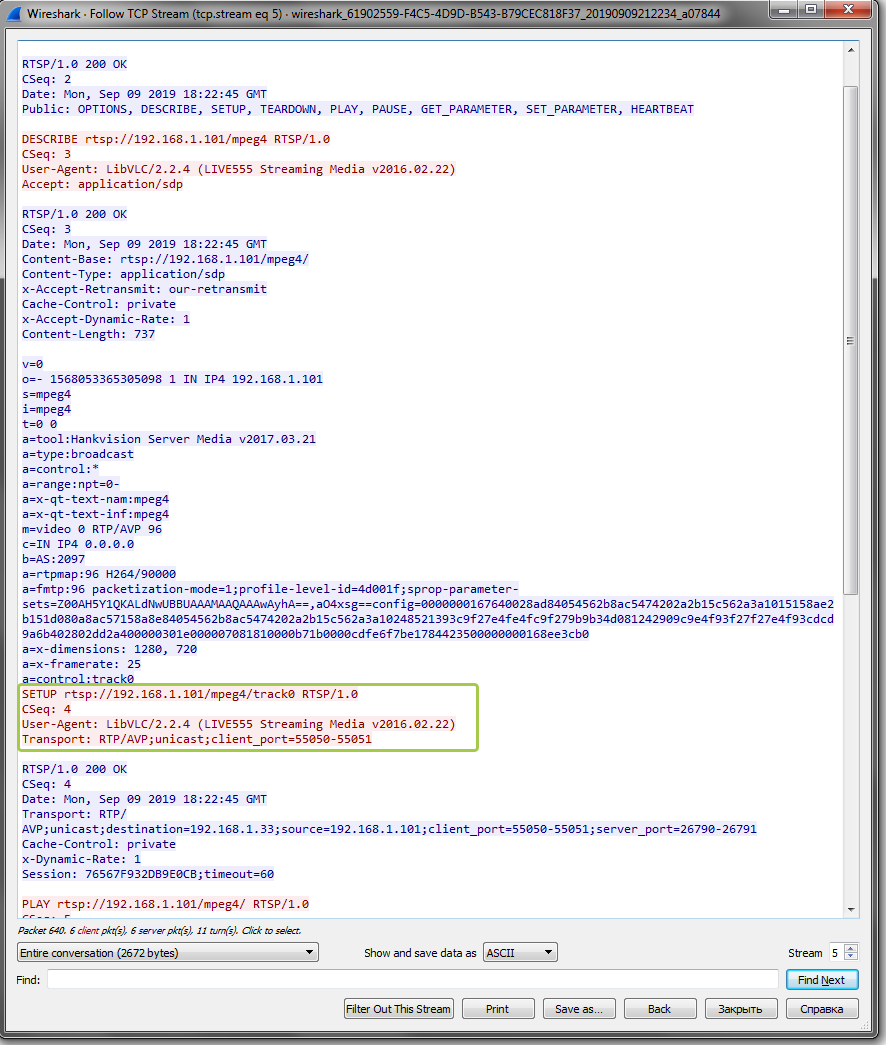

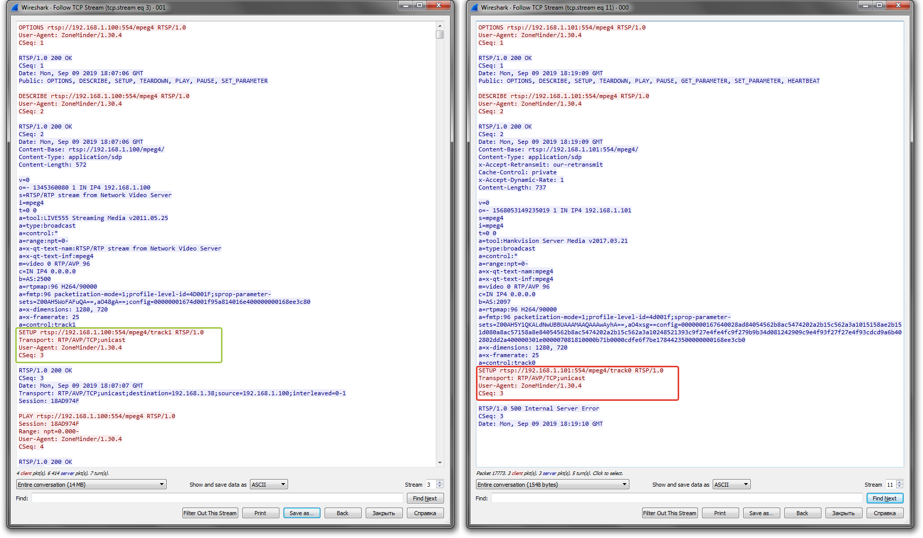

Post by 400k4a » Mon Sep 09, 2019 7:06 pm
It works now! Great thanks to all!
What I done:
Compared one of the old working cameras (left) with new (right):
New camera in VLC, works:
I've changed Source->Remote Method from RTP/RTSP to RTP/Unicast and got it working:
Resume: the old IPEYE cameras works only with Remote Method set to RTP/RTSP, the new only with RTP/Unicast.
