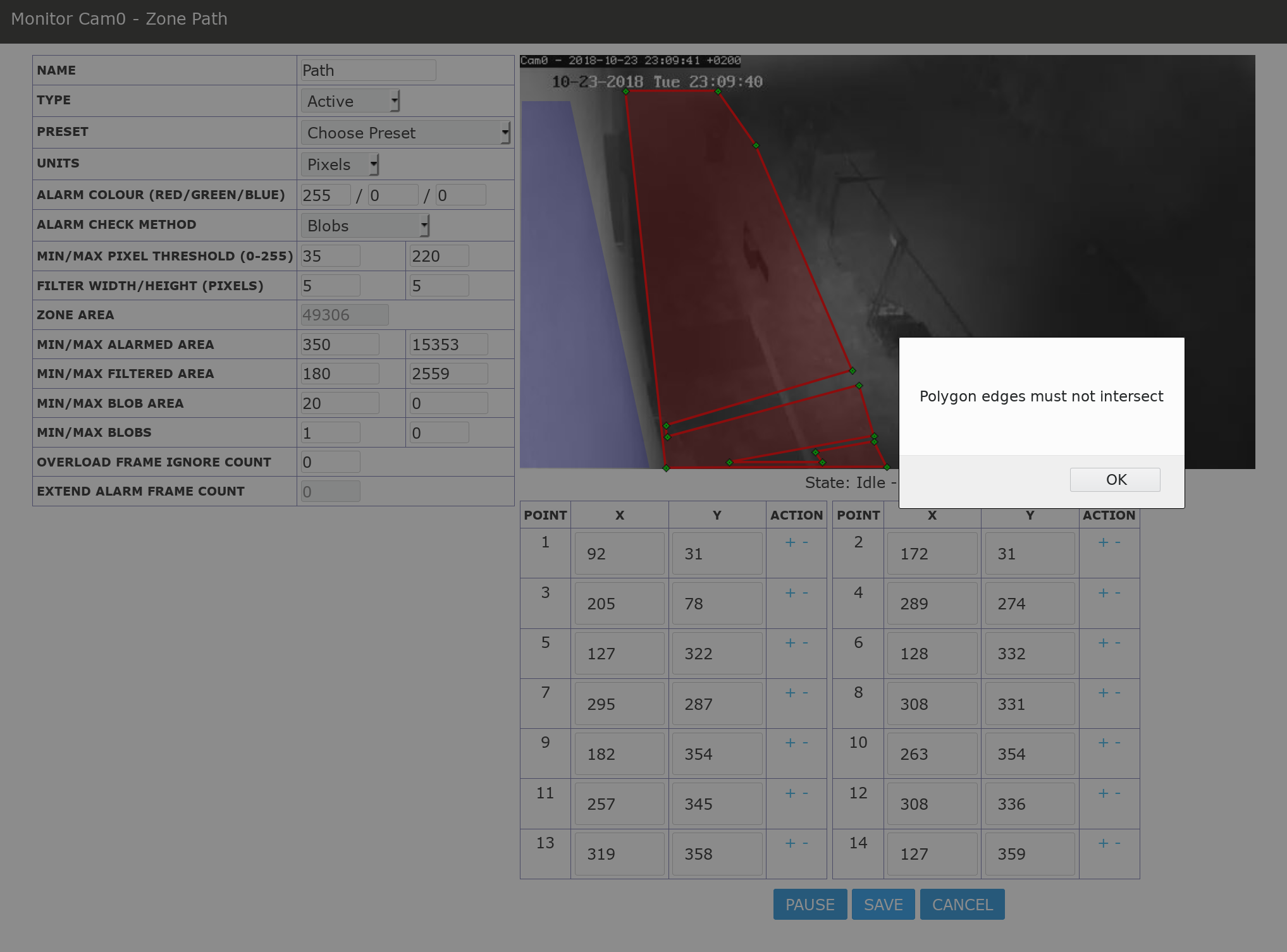

I have a zoneminder instance running and when I try to edit a zone, I get an error message:
polygons must not intersect
They intersect indeed before editing, but after everything looks ok for me (see attachment).
Has anybody an idea what is going wrong?
zoneminder release: 1.30.4
Any idea on how to get around this issue is welcome.
Many thanks
Rainer
Polygons must not intersect
- polygons-must-not-intersect.png (233.95 KiB) Viewed 3518 times
Re: Polygons must not intersect
First thought: Move the points that are VERY close to the edge away from edge of frame, I've sometimes had complaints when getting right near the edge.
Second thought: Take out those two funny little insertions into the polygon, it looks like you could cover this area with a 4 sided polygon and save the headache.
Obviously you know more about the area being covered than I do, but what are you trying to avoid in those thin slivers, does an incredibly thin person come along and pogo-jump several times a day?
Many thanks for your quick reply.
I simplified the polygon now a lot(see attachment), but I still get the same error message.
Not sure if I fully understood your last comment: the thin slivers see light through the glas in the door, I want to cut that out to avoid false alarms.
Rainer
Rainer
- polygons-must-not-intersect-2.png (245.24 KiB) Viewed 3496 times
Maybe I should add that I had intersections before I edited the polygon, but if the error message refers to that it clearly comes to late, I just fixed an intersect issue in the the polygon edges.
My last comment was partly a joke, but the point was serious: Trying to create tiny "avoidance" areas like that seems a lot of effort, gives ZM more work to do, and seems remarkably precise as to the shape of the thing you are cutting round.
Hint: Look at "exclusion" zones too, as they can be used to prevent part of the picture from triggering an event.
Many thanks for your reply again.
I deleted the entire zone and recreated it, that solved the problem.
I also used "inactive" zones on top of a simpler "active" zone now.
