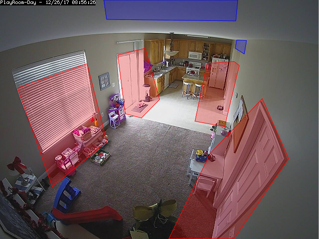

The trick is to make them small, sensitive, and place them in areas where a real alarm would not occur, like high on the wall where lighting changes occur or a ceiling that gets illuminated by the IR light. Use the Extend Alarm Count setting to disable alarms for a couple seconds after the preclusive zone is activated. For example, here are the settings I'm using for one of mine:
Zone area: 0.14% of frame
Units: Percent
Alarm check method: AlarmedPixels
Min/Max Pixel threshold: 10, 0
Min/Max Alarmed Area: 10, 0
Overload frame ignore count: 0
Extend alarm frame count: 4
That is the small zone above the hallway in the image. I also have one on the ceiling which takes care of the IR light coming on and off. (Though now that I look at it, it probably doesn't need to be that big.) I rarely get false alarms due to lighting changes with this setup.
- zones1.png (537.21 KiB) Viewed 1390 times
