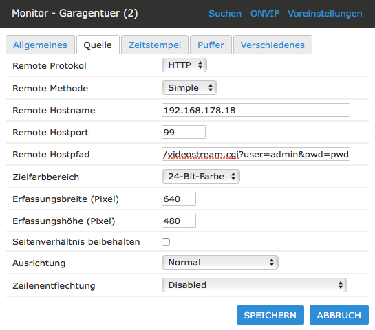

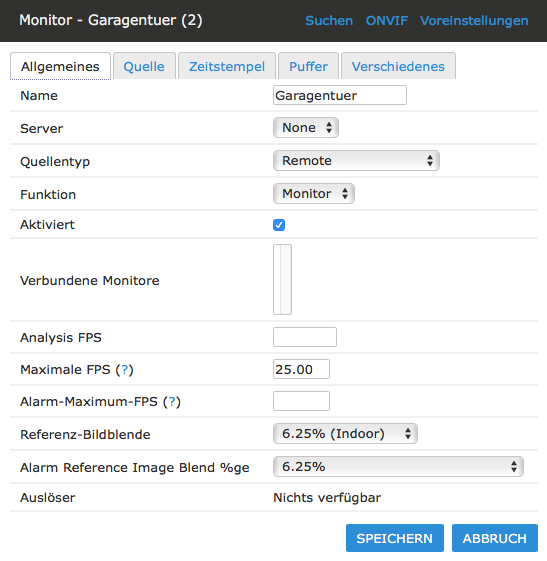

I'm trying to get my new camera with Zoneminder to run for days. I already have as much as everything I have found on the internet to get zoneminder to run.
I have installed zone minder like this: https://wiki.zoneminder.com/Ubuntu_Serv ... e_easy_way
The camera settings think I am right in zoneminder. It is the Wanscam JW0011 camera and with another service the camera with the same settings shows a picture.
I'm not sure if the connection to cgi-bin is correct in my system. I have however also still no possibility found this out.
I have already changed the PATH_ZMS to /zm/cgi-bin/nph-zms

My options in Zoneminder for my Wanscam JW0011 Camera
Bildschirmfoto 2017-10-02 um 23.21.02.png (61.6 KiB) Viewed 14907 times
Bildschirmfoto 2017-10-02 um 23.21.28.png (65.34 KiB) Viewed 14907 times
Hope anybody can help me to get Zoneminder working without the hundreds of errors from my first post.
Thank you very much!
