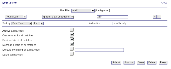

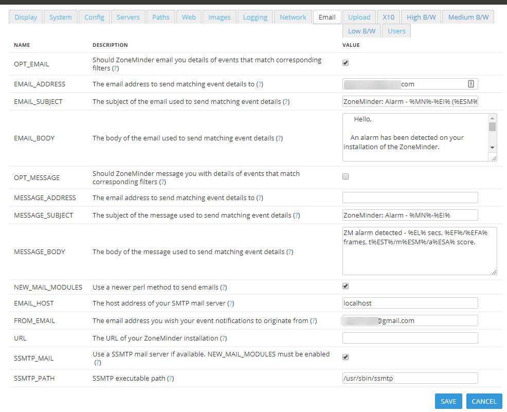

See here screenshot of my options screen:
I've tested ssmtp from the command line and that works.
Can you guys help me out here? Thanks.

Thanks for the screenshots. My settings are identical. The weird part is that I do not see any log about sending an email. I don't know how to debug this any further.

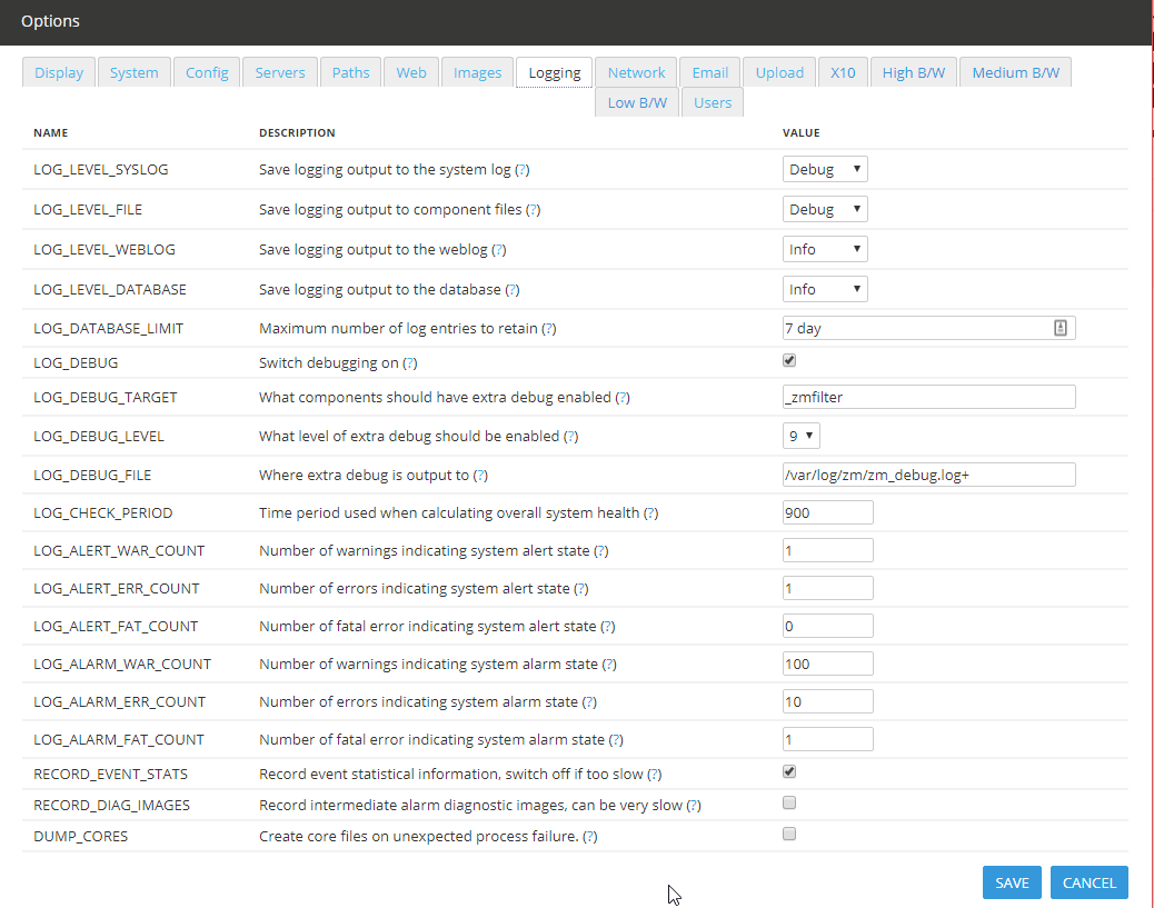

I've set log levels to the following:
But I don't see any logging about ssmtp or sending mail. I've tailed syslog and debug log.
Should there be a zmfilter.log file in the /var/log/zm folder? Because that doesn't exist in my setup.
