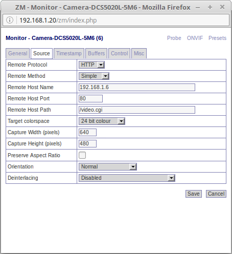

Here is my setup:
Source Type : Remote
Remote Protocol: HTTP
Remote Method: Simple
Remote Host: 192.168.1.6 "IP address of the DCS5020L" Note I'm not able to save this according to the instructions "Remote Host Name: user:pass@IP Address of Camera" I get this error- Host must be set to a valid ip address or hostname, do not include http://.
>>>>>>>>This seems to be a bug in ZM 1.30, so if someone has experience with a work around. Please let me know! <<<<<<<<
Remote Host port:80
Remote Host Path: /video.cgi
Target Colorspace: 24 bit color
Capture width:640
Capture Height (pixels): 480

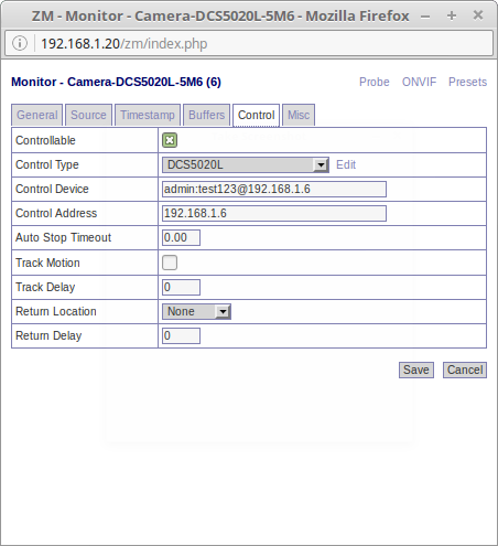

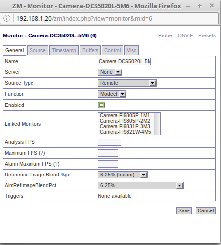

Ok first thanks for replying I appreciate the support! Love the product! Using your comments will address each in turn a step at a time. Comments in line below.
1) Start by providing screenshots of your monitor config.
My camera is a:
D-Link-
DCS5020L:
General Tab:
Source Tab:
Here is the error I get when I save the configuration:
I'm forced to remove the “admin:test123@" before saving. So I had to save just "192.168.1.6” without giving me the above error. As a result I'm gettting "Failed authentication" on the error logs
OMG its working I'm able to save it right now. While preparing these screenshots I was able to save the configuration. So now that I’m totally embarrassed here with egg on my face I of course now have images.

Sorry for the previous post it didn't turn out the way I wanted it. I think I have the hang of the interface now.
I said I was having issues getting the upload to work correctly for me anyway here is the missing Source Tab
That said, I would like to look at the PTZ not working since I now have image capture working. Here is my Control Tab.

linuxnutt
Posts: 37
Joined: Fri Aug 12, 2016 6:06 am
Re: D-link DCS2050L Blue Screen no PTZ on ZM 1.30
Post by linuxnutt »
Sorry, I do not have PTZ control. Here is the output of the sudo perl /path/ to/ DCS5020L.pl file:
sudo perl /usr/share/perl5/ZoneMinder/Control/DCS5020L.pl
I do not get any errors
To associate the New DCS5020L control I followed the information given here:
https://wiki.zoneminder.com/How_to_cont ... eras_-_PTZ
and special attention to follow the steps in these headings - I hope this wiki page is correct.
How to set up ZM to recognize the script
The proper way
How to associate a camera to your new control.
To create the new DCS5020L control values I used this post:
https://wiki.zoneminder.com/D-Link#DCS- ... _DCS-5025L
with these settings:
PTZ Settings:
Main: Type: Remote, Protocol: DCS5020L, Name: DCS5020L, Can Wake, Can Sleep, Can Reset
Move: Can Move, Can Move Diagonally, Can Move Mapped, Can Move Relative
Pan: Can Pan, Min Pan Step 1, Max Pan Step 30
Tilt: Can Tilt, Min Tilt Step 1, Max Pan Step 30
Presets: Has Presets, Number: 24, Has Home Preset
I have compared my PTZ settings to these and they are the same. I would post screen shots except I'm not able to upload more than three files and then I see only two screen shots in the post. I have sent an email to Administrator using the "contact us" icon.
I get this error when I use my mouse to push right &gt;<br />arrow in the PTZ control link..
I get this error when I use my mouse to push right >
I hope this gives more info to determine why I'm having difficulty with the PTZ controls.
Thanks,
Steve
AKA Linuxnutt
2016-08-16 00:21:17.583450 zmcontrol 30344 FAT Can't load ZoneMinder::Control::DCS5020L zmcontrol.pl
This error means exactly what it says. ZoneMinder can't find your control script.
Make sure you:
- placed the script into the same folder as all your other scripts
- make sure the web user account has read permission to the script
- You have to name the script "DCS5020L.pm". It is case sensitive!
- In the web console, under the PTZ definition, make sure the "protocol" field says DCS5020L
For future troubleshooting, you can sometimes get better output from ZoneMinder by executing ptz commands from the command line rather than the web browser:
sudo zmcontrol.pl --panstep=22 --command=moveRight --id=6
