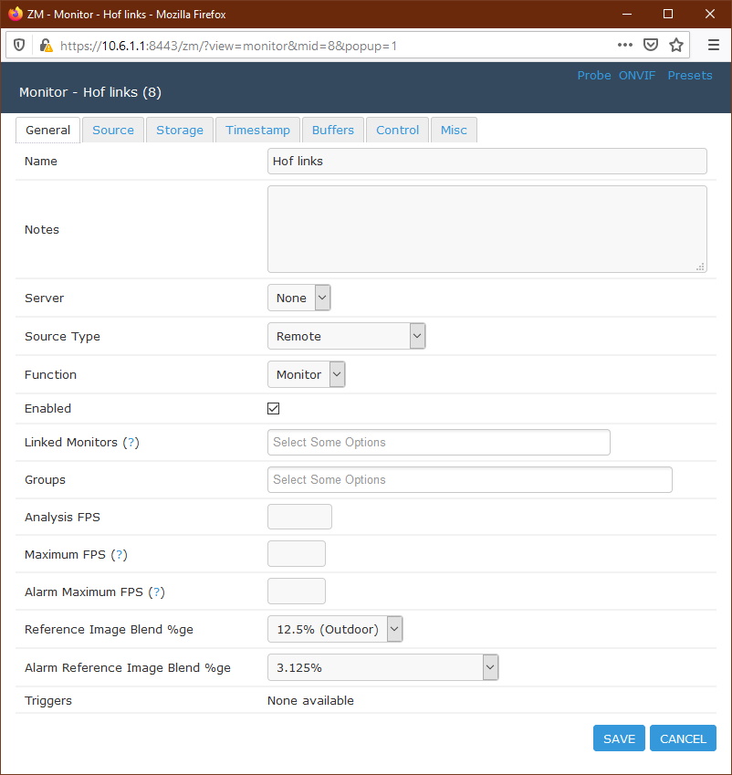

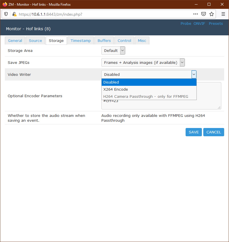

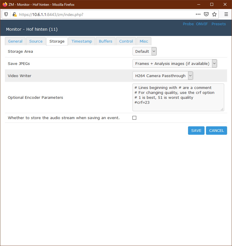

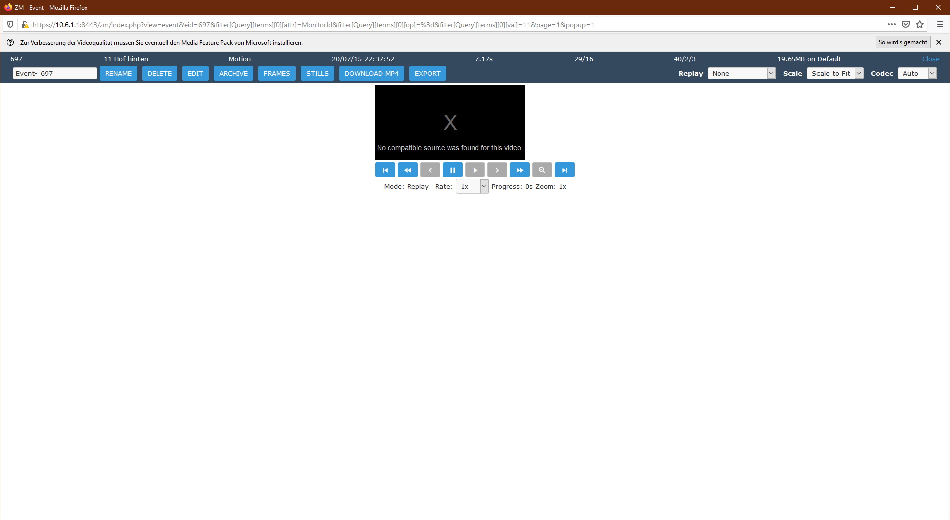

i use an i5@3.2Ghz with Zoneminder in the dlandon-Docker and actually 7 Cams for testing and learning. But if i use modect for more than 2 Cams, htop shows me 100% on every cpu. i think, this is way to much cpu-usage, even for this "old" cpu.
i think (as a newbie) that the cams are not properly set up and the conversion of the events to jpeg might be the problem. so i found the setting "Video Writer" at Storage, but H264 Passthrough seems only possible if i use ffmpeg. so i changed my cam-setting from remote to ffmpeg and recieve smearings.
i dont know, where to start looking for the problem.
i will post some pics with settings from 2 cams.

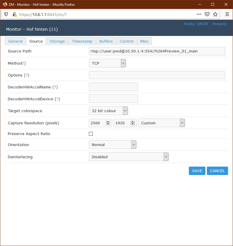

Re: difference ffmpeg and remote?
2 more pics...
- Zoneminder_Ffmpeg_5.jpg (210.86 KiB) Viewed 5134 times
- Zoneminder_Ffmpeg_4.jpg (180.01 KiB) Viewed 5134 times

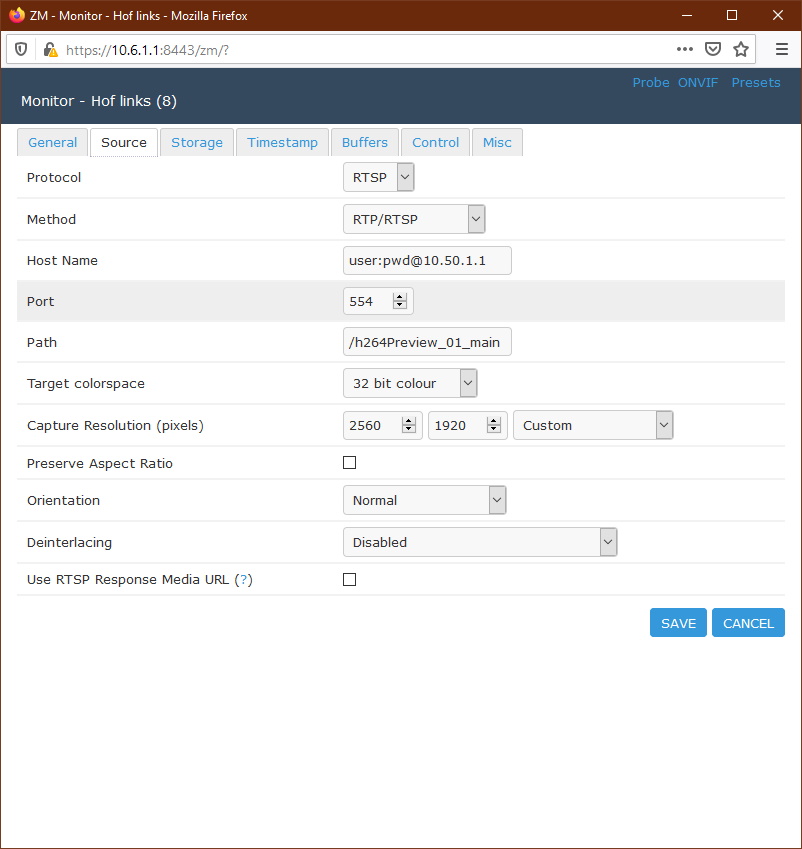

... and the last 3 from the cam with remote-settings
- Zoneminder_Remote_3.jpg (114.58 KiB) Viewed 5134 times
- Zoneminder_Remote_2.jpg (118.71 KiB) Viewed 5134 times
- Zoneminder_Remote_1.jpg (131.63 KiB) Viewed 5134 times

the best pictures without loss at montage review do i have with the remote-setting.
And the Cams are reolink 410 5mp...
