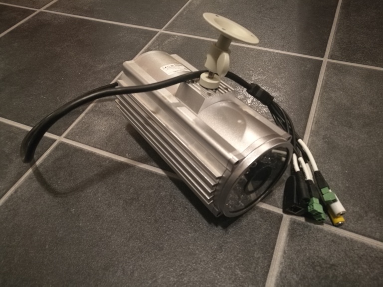

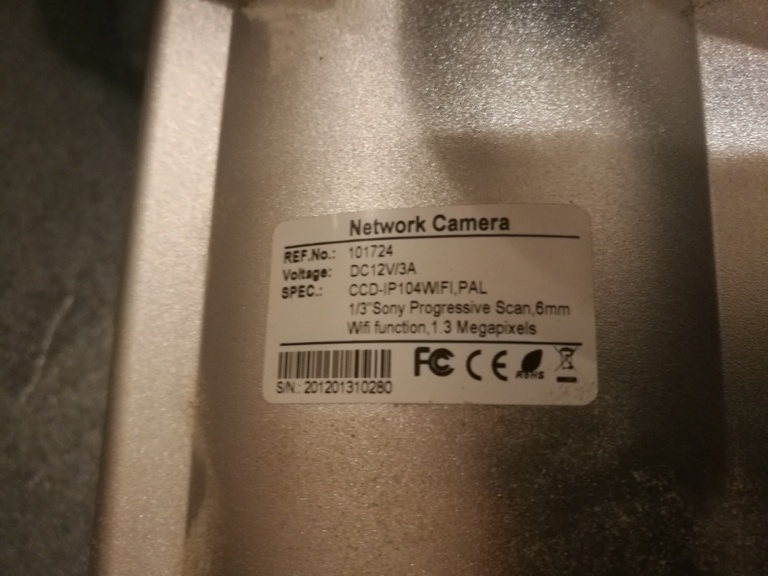

I got couple of used ip cameras from my friend while ago and today I thought try to set them up. I didn't even get started with these because I'm not able to get any connection to these. Seems that these are not getting ip address from the router dhcp after reseting. Does anyone has idea what could be the brand for these cameras and is there any manuals available for them ot how to get connected to them? See images of the camera below:

Do they even work
-- you seem to have some other connectors, are they for audio/composite video/DC power etc. ?
Also they say "wifi function" -- if they are looking for you friend's WIFI network, that may be a stumbling block.
They may not get IP addresses from your dhcp server, if they are configured to use static IP addresses, so that's not necessarily a problem.
I suspect if you find the little hole/button for factory defaults, it will revert to dhcp (or at least a standard IP address for the model).
Ask the friend if they used static/dhcp when last in use? Do they know what the IP addresses were?
If there's NO logo or anything visible externally, you may have to cautiously open one to see reference numbers on circuit boards (if you are comfortable), as sometimes one thing is branded as another thing, or not branded at all externally ...
To discover if the cameras are emitting any kind of packets, you may need to connect them as a single device to a PC (no other networked items/hubs/routers to get in the way), then power them up while watching -- through a tool like tcpdump, wireshark etc. to see if they send any packets.
This will give you a clue to their IP address. They may not grab an IP address, but may do other stuff (seeking an NTP server for time, secretly logging into their Chines secret control hub, who knows ...

Looks remarkably similar to what foscam sold as a 9805 or 9804. If the reset button doesn't work, you can use wireshark or tcpdump to listen to what its sending out. It may have the ip info as mentioned in the previous reply. Post some pictures of the inside, if you are able. You can compare with foscam hardware to double check.

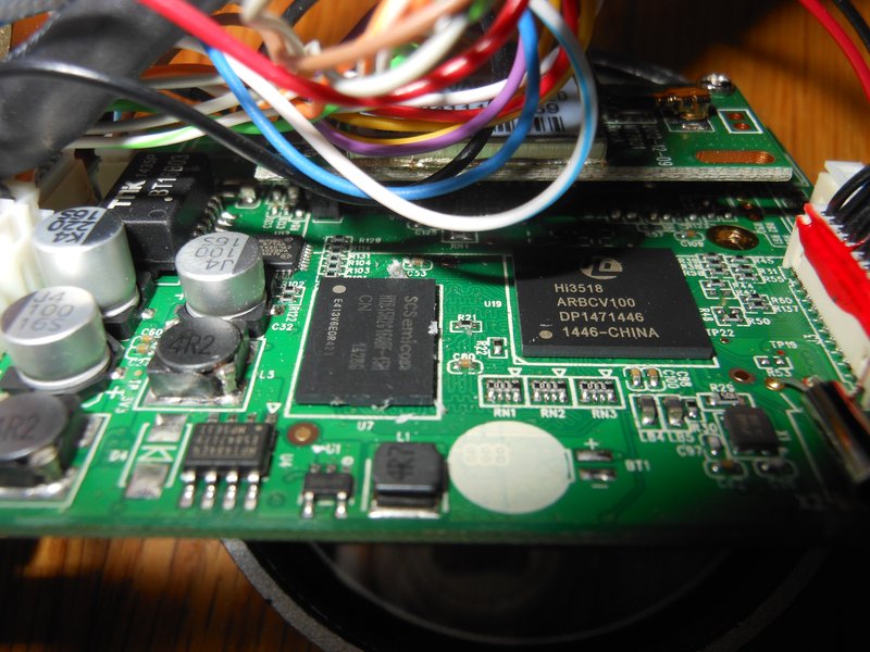

I decided to open one of these cameras to see if I could find some more information about manufacturer. Unfortunately there wasn't very much information that can be easily seen. Only brand that I was able to find there was Sony -text on the chip at the camera unit. Here are couple of pictures from opened device attached below.

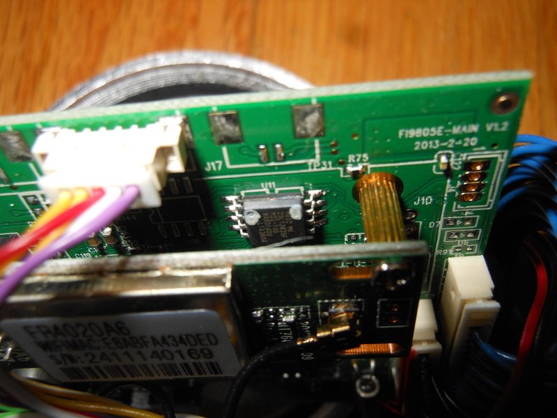

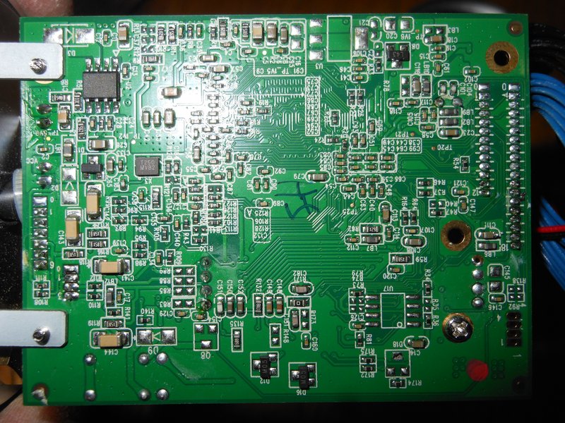

You came through with the pictures, so I'll post some from a 9804 Foscam that I had hanging around. I'm still curious what kind of main CPU is on the long board on your camera. Unfortunately, I didn't take a zoomed out picture, but the design is essentially the same. There is the one long board which hosts the CPU, with some connectors going to the front image sensor board. There is a wifi module connected to the main board, and the long board connects to the sides of the chassis. Here's the main board. The main CPU is a Hi3518.
Here you can see the big amount of wires that come in from the ethernet cable. The wifi module is also in the back. It's connected by a screw, and a few 0.1" headers. There are a lot of wires on the external ethernet connector. Some 20+ wires come in from it. It makes for the thick cable that you see on the outside.

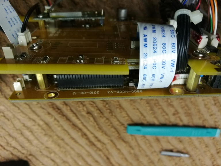

Back of the main board. This board connects to the back of the chassis through some hardware, and slides into the sides, similar to the previous camera.
Note that the main board says 9805. The image sensor board says 9804, so it may be that the only difference between the 9805 and the 9804 is the image sensor.

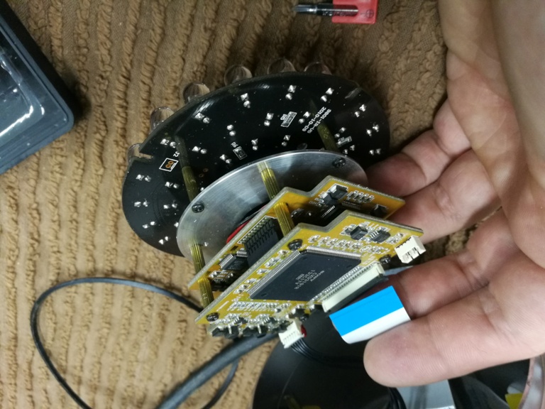

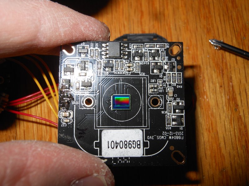

Finally, we have the image sensor.
One thing I noticed when tearing this apart, is that it's pretty easy to add a new zoom lens to these cameras. If you take off the top and then unscrew the front, you have easy access to the lens, without needing to open the rest of it up.
And then the back of the image sensor.
I didn't include the LED board, which has I think 10mm LEDs on it, and a light detector. If you want to disconnect the LED board, or the IR cut filter solenoid switch, it's possible to just unplug the power connectors.
