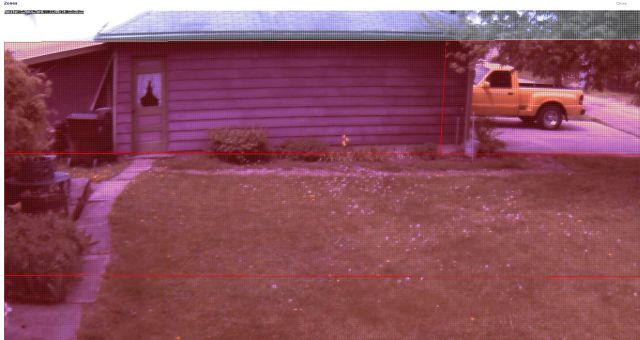

My initial pass at zones was to make one across the top extending from the top of the frame to just below the gutter on the garage. (Why monitor an area that no one can access?) A second zone was added as a rectangle over the driveway area with the last zone being the rest of the frame. I tried to match the edges of existing zones as I added new ones and not allow them to overlap but I don't know how important that is. I used percentages and Blobs as my initial settings looking at the presets to see what the settings should look like, then referring to the Wiki page to understand what they meant.

In my initial attempts to set the Alarm, Filter and Blob percentages, I found that my large zone representing the grassy area did not have enough filter resolution. Meaning that if I set the alarm percentage low to capture me when I was far from the camera close to the garage where I was a small percentage of the large zone, changes closer to the camera tended to generate false positives. Of course this makes perfect sense, the closer object is larger in the frame and so is a larger percentage of the zone. As I walked away from the camera, my image got smaller and was a proportionately smaller percentage of the view.
So the obvious solution was to break up the view into more zones. I added 2 horizontal zones so that I could fine tune the percentages based on the distance from the camera. I made the zones about man height. A few more walkthroughs and I was able to tweak the settings very nicely. Most are set to 4,3 and 1 respectively.

Final zone config.
Final zone config.
