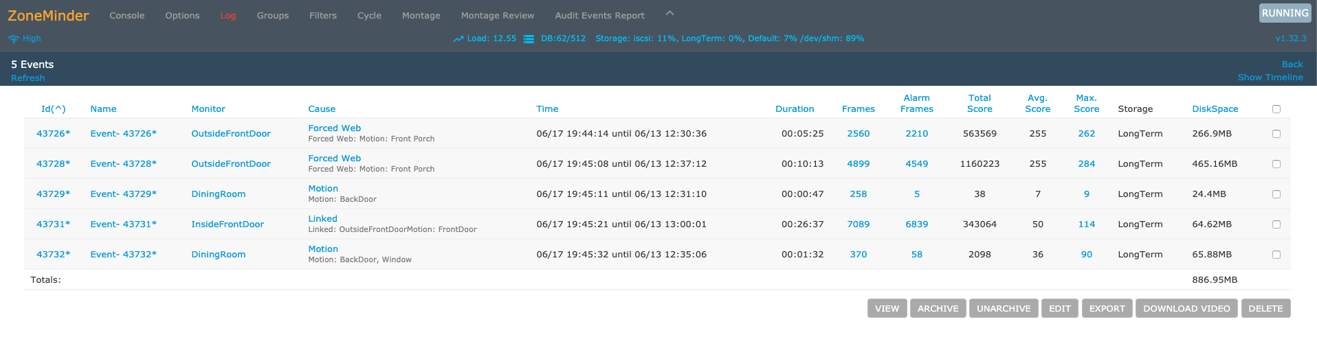

As you can see in this
Screen Shot 2019-06-17 at 1.57.48 PM.png (138.82 KiB) Viewed 7454 times
the start date is now listed as today but the end date is the original end date of the recording.
I've disabled zmaudit in the configs but its still changing the date to the wrong date.
EDIT: Also once it has that date mixed up in the system the recording can no longer be played.
EDIT2: Didn't realize that zmaudit after disabling it was still running so I did a kill -9 on the PID of the script and I'm hoping that this will now take care of this.
