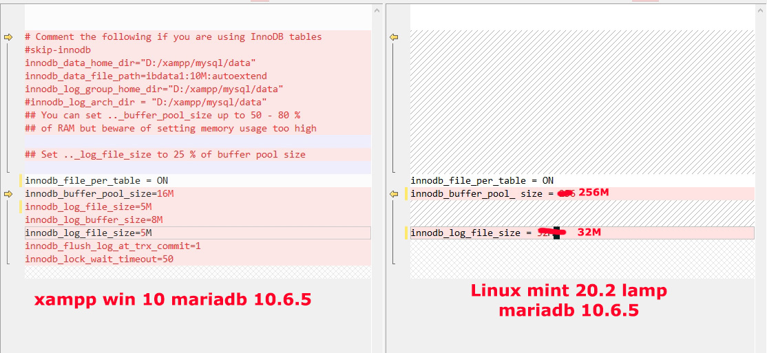

The guide contains another error that's probably preventing the database from starting...
innodb_log_file_size - 32M should be innodb_log_file_size = 32M (equals instead of minus)

kitkat wrote: Mon Nov 29, 2021 2:37 am The guide contains another error that's probably preventing the database from starting...
You have hawk eyes, good find !!! I will try it now
ALSO an extra space
innodb_buffer_pool_ size = 256M

kitkat wrote: Mon Nov 29, 2021 4:10 pm Any problems when you changed the size of the InnoDB logfile?
I tried 1/2 the values no go
innodb_buffer_pool_size and innodb_log_file_size have default values if not set acorfing to mariadb so I entered those values and it still tanked. wish I wrote them down.
If I comment out the innodb all boots and runs fine in zm from what I see
Its bugging me, I don't want it to reflect on zm if someone new has the same problem

I think that the failure to start is very probably related to changing the size of the InnoDB log files (barring any other typos and errors in the guide of course!), but this is coming from my CentOS-centric perspective and it may be that mariadb/MySQL doesn't behave this way on other distros.
The mariadb log (/var/log/mariadb/mariadb.log on CentOS) should show what's going on - This will display the last ten errors in that file:
grep -i error /var/log/mariadb/mariadb.log | tail
If the output contains something like this then the log files are very likely to be the problem:
InnoDB: Error: log file ./ib_logfile0 is of different size 0 78643200 bytes
(The lack of such output doesn't rule out the log files being a problem because there may be later errors hiding them and you should inspect the logs in more detail.)
If you do see those errors then you can try this to see if they self-repaired:
grep -i "InnoDB: Log" /var/log/mariadb/mariadb.log | tail
A good result would look something like this:
190319 16:17:05  InnoDB: Log file ./ib_logfile0 did not exist: new to be created
(The leading digits are a YYMMDD datestamp so you can tell whether they're recent or not.)
So, if you see errors but not 'to be created' messages then the log files may well be the problem, and you should be able to fix it like this:
# Stop the database server
sudo systemctl stop mariadb
# Move the old log files out of the way.
# We could delete but let's keep them so we
# can put them back if it still fails
sudo mv -f /var/lib/mysql/ib_logfile? /tmp/
# Edit my.cnf and add the innodb_* entries
# to the [mysqld] section
sudo nano /etc/my.cnf
# Restart the database
sudo systemctl start mariadb
# Wait a few seconds and then look for messages in the log
Hopefully you'll see a "InnoDB: Log file ./ib_logfileX did not exist: new to be created" message or two, but if it still doesn't start then you'll have to inspect the logs for other problems.
A very minor thought is the spaces around the ' = ' in my.cnf. I'm sure they're probably fine but I've never seen them used and I always avoid whitespace where possible. My my.cnf contains these innodb_* directives under [mysqld]
innodb_stats_on_metadata=off
innodb_file_per_table=on
innodb_log_file_size=128M
innodb_buffer_pool_size=1024M
(If you use other values, log_file_size should generally be one-eighth of buffer_pool_size.)
Good luck!

Nov 30 10:37:38 POS-SERVER sh[5099]: error: Found option without preceding group in config file: /etc/>
Nov 30 10:37:38 POS-SERVER sh[5099]: Fatal error in defaults handling. Program aborted
Nov 30 10:37:38 POS-SERVER mariadbd[5102]: error: Found option without preceding group in config file:>
Nov 30 10:37:38 POS-SERVER mariadbd[5102]: Fatal error in defaults handling. Program aborted

grep is saying "/var/log/mariadb/mariadb.log: No such file or directory" so your log file isn't at /var/log/mariadb/mariadb.log.
Hmm.. Or perhaps it is there but you need sudo to access it? (I always forget that bit because I'm usually root. Yeah, I know...) To avoid that sort of problem you could probably sudo su and get root privileges for the whole session.
Basically, try the grep stuff again but prefixed with sudo (and a space!) or make sure you have root privileges some other way and see what it says. If it still says it can't find the file then you'll have to locate it and substitute the correct path in the commands.
Some of the things I posted and which you tried were examples of output rather than actual commands ;)
This looks to be a problem though:
There may of course be other flog_file_size related errors to come but it's not even getting that far. Maybe paste your entire my.cnf here so we can see what it looks like, with the edits and without.

kitkat wrote: Tue Nov 30, 2021 5:27 pm Maybe paste your entire my.cnf here so we can see what it looks like, with the edits and without.
There is no my.cnf, well there is but empty, Mariadb uses 50-server.cnf
Inno is commented out with #, this is a clean install
GNU nano 4.8 /etc/mysql/mariadb.conf.d/50-server.cnf

I tried to set "log_error = /home/ljimmy/desktop/error.log" so I don't have to dig for it ( no good) won't write to it.
enabled it at log_error = /var/log/mysql/error.log
2021-12-01 15:54:21 0 [Note] InnoDB: Compressed tables use zlib 1.2.11
2021-12-01 15:54:21 0 [Note] InnoDB: Number of pools: 1
2021-12-01 15:54:21 0 [Note] InnoDB: Using generic crc32 instructions
2021-12-01 15:54:21 0 [Note] InnoDB: Using Linux native AIO
2021-12-01 15:54:21 0 [Note] InnoDB: Initializing buffer pool, total size = 134217728, chunk size = 134217728
2021-12-01 15:54:21 0 [Note] InnoDB: Completed initialization of buffer pool
2021-12-01 15:54:28 0 [Note] InnoDB: 128 rollback segments are active.
2021-12-01 15:54:28 0 [Note] InnoDB: Creating shared tablespace for temporary tables
2021-12-01 15:54:28 0 [Note] InnoDB: Setting file './ibtmp1' size to 12 MB. Physically writing the file full; Please wait ...
2021-12-01 15:54:28 0 [Note] InnoDB: File './ibtmp1' size is now 12 MB.
2021-12-01 15:54:28 0 [Note] InnoDB: 10.6.5 started; log sequence number 25138040; transaction id 64310
2021-12-01 15:54:28 0 [Note] InnoDB: Loading buffer pool(s) from /var/lib/mysql/ib_buffer_pool
2021-12-01 15:54:28 0 [Note] Plugin 'FEEDBACK' is disabled.
2021-12-01 15:54:29 0 [ERROR] /usr/sbin/mariadbd: unknown variable 'innodb_buffer_pool_ size=32M'
2021-12-01 15:54:29 0 [ERROR] Aborting
Linux Mint 21 Cinnamon Mariadb 10.6.x using Master 1.37.x latest always
DVB Hardware
Posts: 201
Location: Rhode Island
Re: Lamp Mariadb install error
Post by DVB Hardware »
Well I think I had enough beating a dead horse on this.
I spent days researching Innodb beyond my skills to reason why the settings are there
I have a xampp install for Point of sale testing, same mariadb version on win 10
I used the Innodb settings from xampp in linux and it worked
I also increased the file_per_table and the Log_file_size in linux to 256M and 32M respectively and that worked also, with the additional variables
Crazy as this test was, It didn't matter to me since I would reformat the pc and start over, install expendable.
Im just going to leave innodb settings out and let mariadb use its default variables.
Thanks guys, hope I didn't waste to much of your time
Jimmy
Your logs show it is using the default of 128MB
I'm not sure why you'd want to change it.
