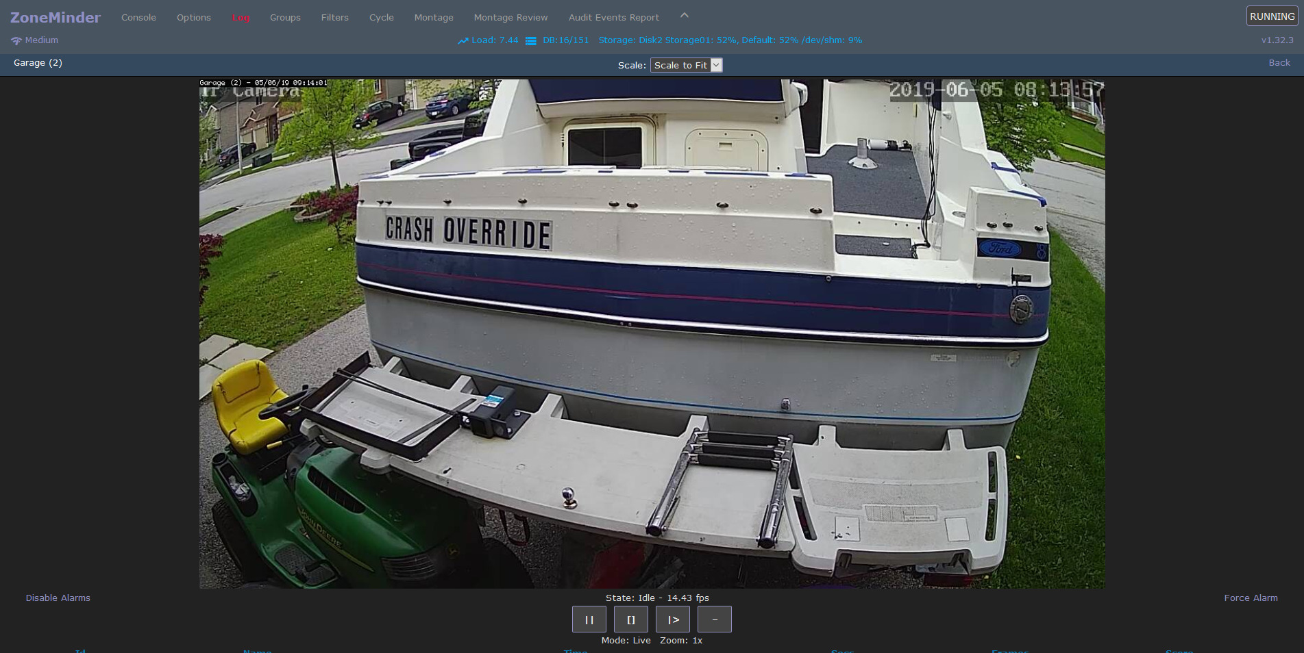

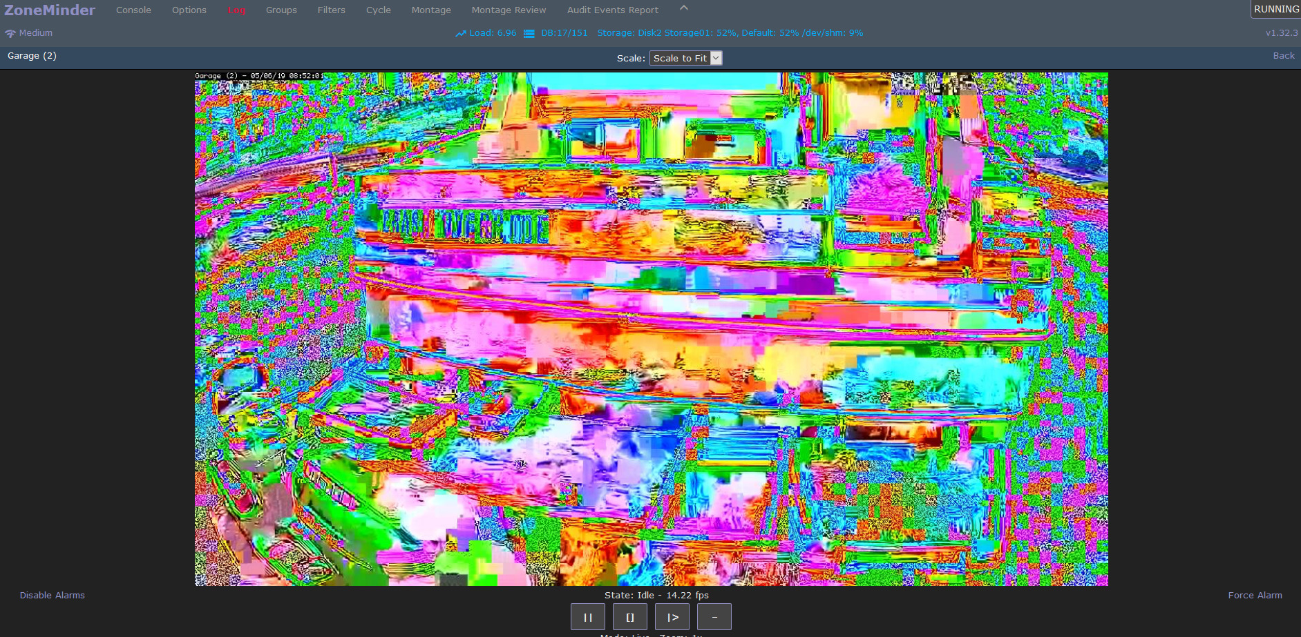

This camera works great, love the camera, plan on getting more but I need to sort out this issue first. When the camera has been running on mocord for longer than 15 hours it starts to get distorted, as in the image attached (see when running fine vs when not). It used to be this would happen within an hour, I changed the fps settings and the problem now takes several hours.
Any ideas where to start? Let me know if there is anything needed. Thanks in advance folks.

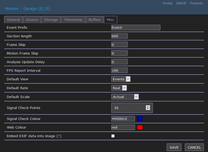

more photos...

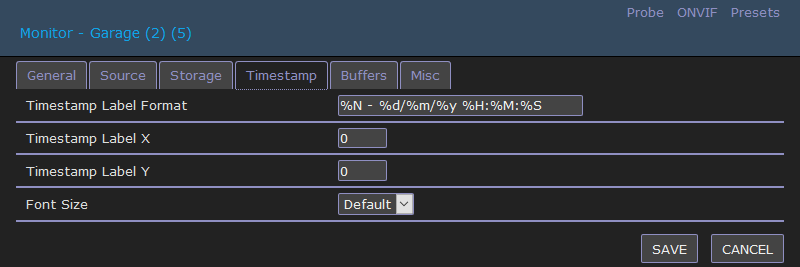

more...

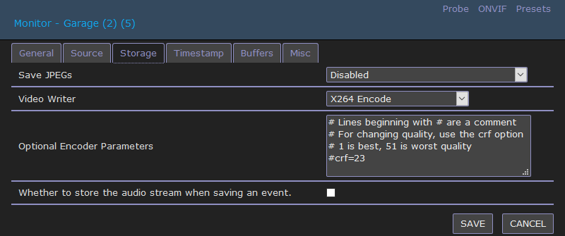

Have you tried using H.264 Passthrough as the Video Writer, instead of X.264 Encode?

kitkat wrote: Wed Jun 05, 2019 10:53 pm Have you tried using H.264 Passthrough as the Video Writer, instead of X.264 Encode?
No, I haven't. Just switched the setting now. I'll report back how it performs!

All great replys. Sorry it took so long to reply - I was waiting to see if the issue was resolved. Kitkat's solution of x.264 Passthrough was the answer. I had already been tweaking with all of the other options for some time and it only made incremental improvements but the passthrough solved it. Thanks a ton!
