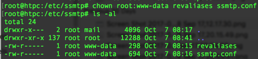

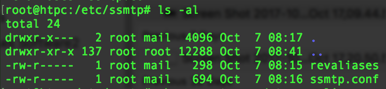

I have checked another thread (viewtopic.php?t=25346), someone says that I need to check the SSMTP config files permission; I did mine and the following is the original one:
Screen Shot 2017-10-07 at 7 Oct 17,09.49.07.png (88.67 KiB) Viewed 6034 times
and the following after the change ownership:
Screen Shot 2017-10-07 at 7 Oct 17,09.49.14.png (122.41 KiB) Viewed 6034 times
Unfortunately, still no email is received.
Can someone please let me know what else should I check now?
