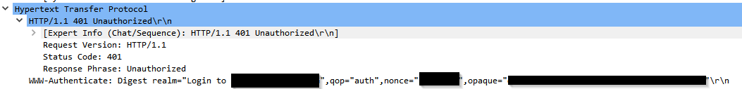

I took this a bit further and verified the base64 encoding of the authentication that is sent to the camera for the Basic Authentication, and that is also correct in the wireshark capture.
What I did find that was odd was the 410 authorization Failure return from the Camera appears to be processing the Authorization as a Digest Authorization rather than a Basic as the return packet from the Camera shows this:
I am by no means an expert on Authorization, but according to the API Documentation this type of response should only be received if a Digest Authentication was attempted.
I guess at this point I am looking to confirm with anyone else who may have been using these scripts with this Camera and is running the same Firmware as I am, or anyone else who is smarter than me that can make sense out of this.

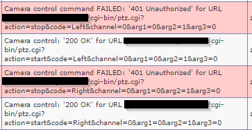

Well I made a little more progress, and to me it's really looking like an issue in the firmware. I added the specific Digest Authorization Credentials to the script and I am now getting 50% success on the calls, unfortunately that means it' still garbage. This is now what my subroutine looks like:
sub Right
    my $self = shift;
    Debug( "Move Right" );
    $self->{ua}->credentials("server:port","realm-from-wireshark","username"=>"password");
    $self->sendCmd( 'cgi-bin/ptz.cgi?action=start&code=Right&channel=0&arg1=0&arg2=1&arg3=0' );
    usleep (500);
    $self->sendCmd( 'cgi-bin/ptz.cgi?action=stop&code=Right&channel=0&arg1=0&arg2=1&arg3=0' );
I also removed the user credentials from the Control Address as I was specifically adding them to the script.
The Camera Moves but doesn't stop. You can see that in the logs here,
so actually getting a request in and accepted but not consistantly. Just doesn't make any sense.
