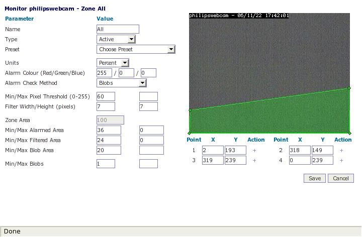

I found that if the area to be monitored is pitch black, the camera creates static noise, which triggers my ZM into recording. Any ideas what I can do?

Maybe you could have a "night time" and "Day time" run states? Change the % of pixels that trigger an alarm for the "Night time" state, so that it will still trigger if someone turns "on" the light at night???

It's like every pixel jumps at every refresh (which is set for 1 second).
So no two picture is exactly alike.. It still did not work when I set it for
"Best, low sensitivity" preset, so I changed the 36% there to 50%, and trying it now. I wish I could run a "soften" filter on the image, then these noises would disappear..
Here is a sample - notice the fine background noise..
http://www.kalfaoglu.com/blanksample.jpg
Many thanks, -t
