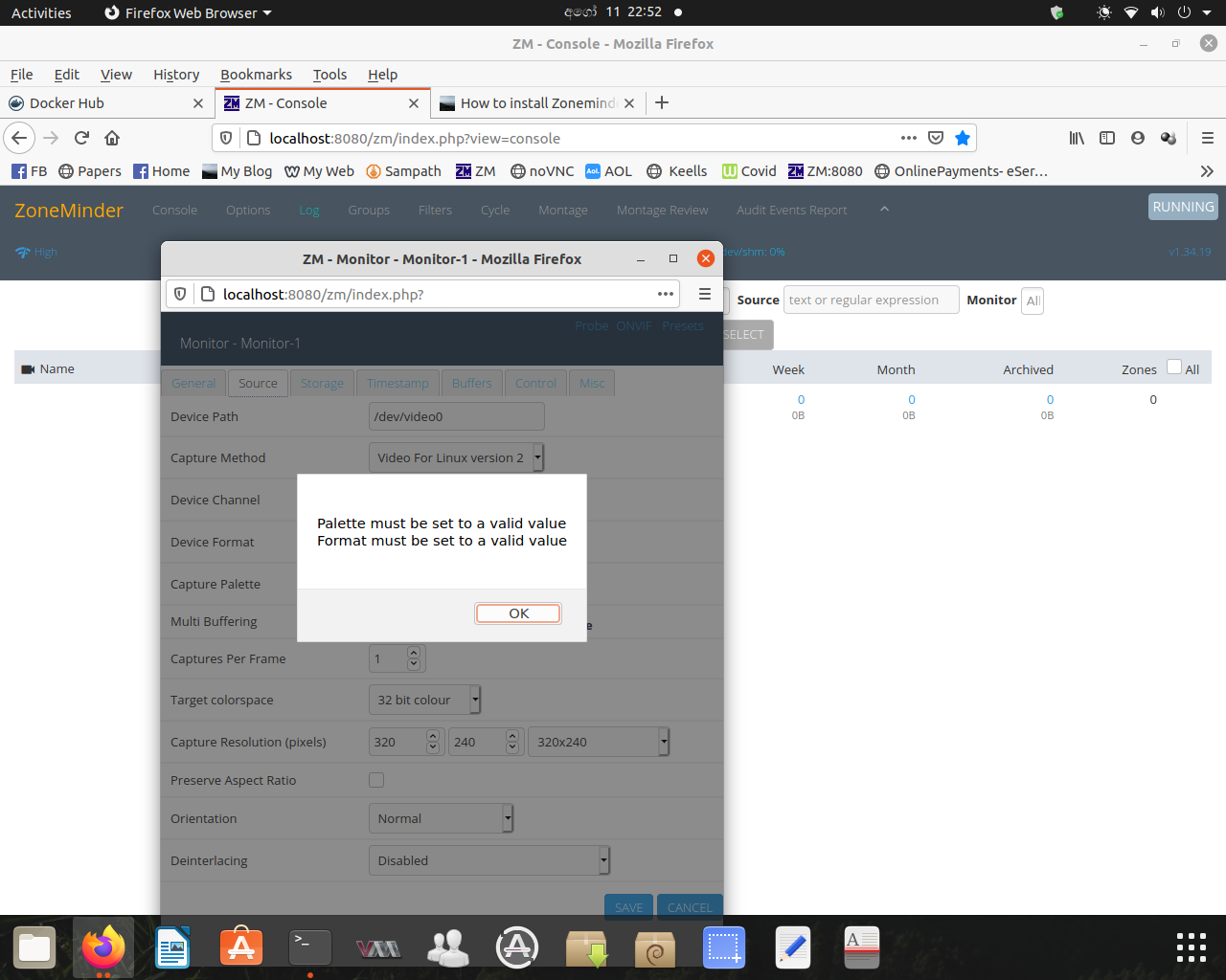

You can't add usb camera to Zoneminder 1.34.19-focal1 issued 1 hour ago .
This problem prevails in versions 1.34.17 to 1.34.19

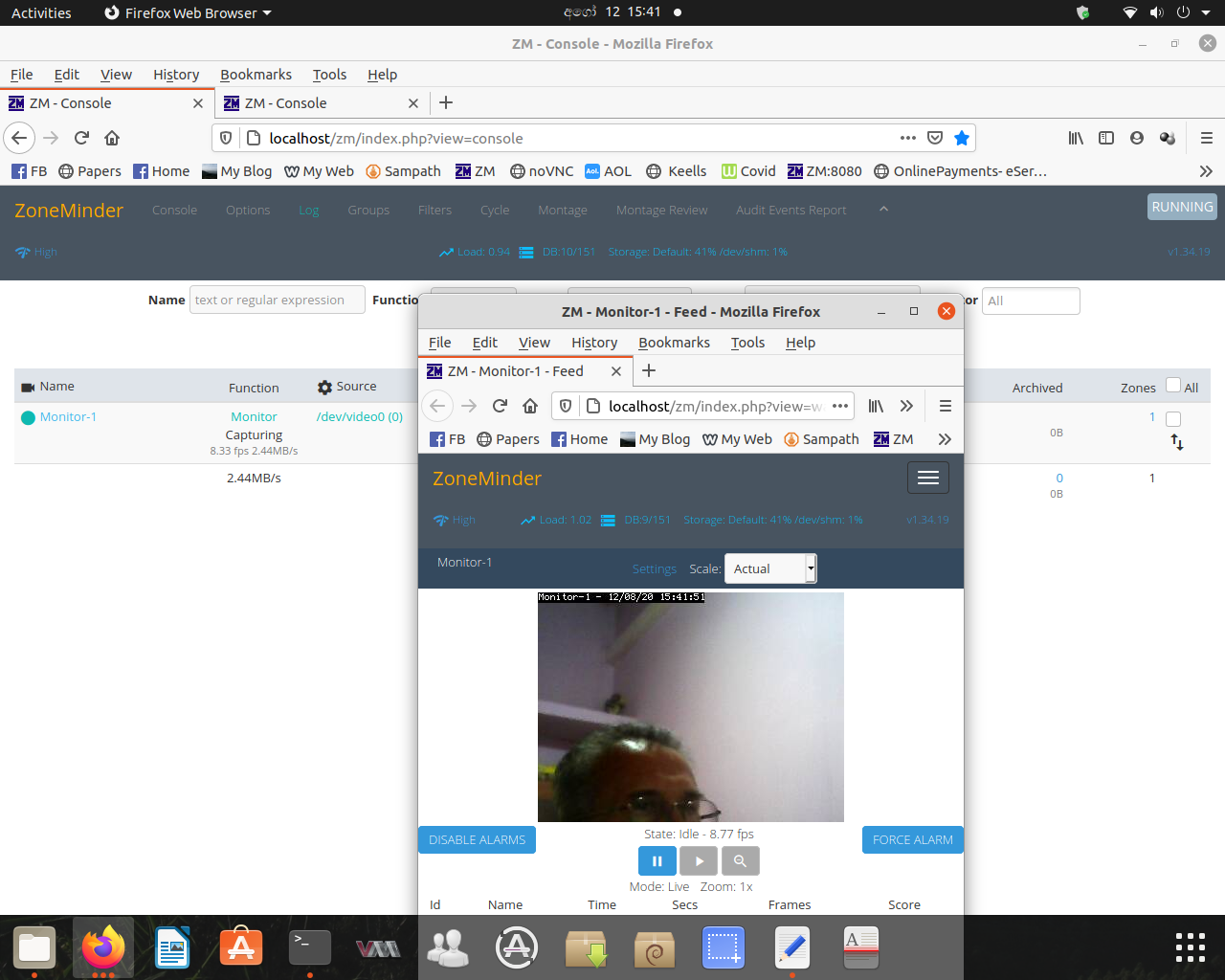

USB camera can be added to Zoneminder 1.34.19 ,when you copy the codes of device format and capture pallet from Zoneminder 1,34.16 to Zoneminder 1.34.19 ,( using the Inspect Element (Q) in the web browser).
Screenshot from 2020-08-12 15-41-52.png (260.77 KiB) Viewed 1858 times
The codes of device format and capture pallet of Zoneminder 1.34.16 , 1.34.19 and Zoneminder master 1.35.5 are attached herewith for comparison
zm16-vs-zm19-zmmaster 1.35.5.txt
(6.24 KiB) Downloaded 185 times
Note:- There is no problem in adding USB camera in Zoneminder 1.34.16 and Zoneminder master 1.35.5 . The problem is only in Zoneminder 1.34.17 to 1.34.19
