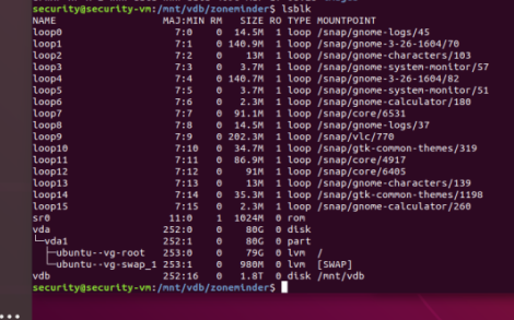

1. Mounted the 2TB drive @ mnt/vdb (correct drive size is being shown in properties and I can move files to vdb folder)
2. Created two folders, zoneminder and events
3. Change permission to www-data

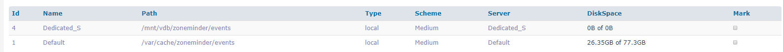

4. Add new storage option in ZM with path /mnt/vdb/zoneminder/events
Issue:
1. When I add the new storage option in ZM it shows 0B/0B as the available space.
2. Log files shows the following errors:
Storage::disk_usage_percent: path /mnt/vdb/zoneminder/events does not exist
Path /mnt/vdb/zoneminder/events does not exist.

Re: Zoneminder and Seperate HDD for recording
What are the permissions of /mnt and /mnt/vdb?
On CentOS they'd both need to have the eXecute bit set for all users else Apache can't see or traverse the directories below them, so maybe it's the same with Ubuntu and other distros?
I would have thought that it should still see the disk size though.
/mnt and /mnt/vdb permissions are currently set as "security". They are not the same as the folders below..I can change them as see if that makes a difference. If the above is right.. makes sense why ZM cant see the size or cant see the folders.
Most of the tutorials that show how to do this doesnt say they need to be changed.. no harm in trying I guess.
The screenshot suggests that the permissions on /mnt/vdb are set to owner-only (rwx------ or 700) so only the security user can read them.
Try chmod-ing that and /mnt to 755 (rwxr-xr-x) so that other users can read and 'execute' them.
chmod 755 /mnt /mnt/vdb
