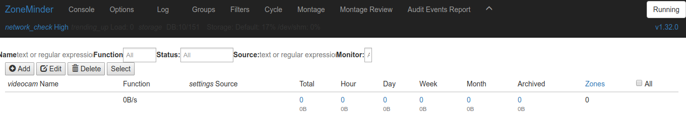

Screenshot at 2018-09-27 08-48-56.png (41.48 KiB) Viewed 10622 times
I realized the Web interface might have some indications as to what part of the config is messed up.
Seems like elements like Name and Source are displaying fallback info rather than the intended content.
Does this help anybody to give me a clue?
