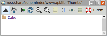

example of the folder structure of the API:

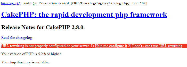

I managed to fix the rewrite issue. In my system httpd.conf file, the line
LoadModule rewrite_module libexec/apache2/mod_rewrite.so
was commented out. I removed the proceeding "#" as explained here:
https://book.cakephp.org/2.0/en/install ... iting.html
Additionally, I had to change my .htaccess files in the directories api and api/app to look like this:
<IfModule mod_rewrite.c>
    RewriteEngine on
    RewriteRule    ^$    webroot/    [L]
    RewriteRule    (.*) webroot/$1    [L]
    RewriteBase /api
</IfModule>

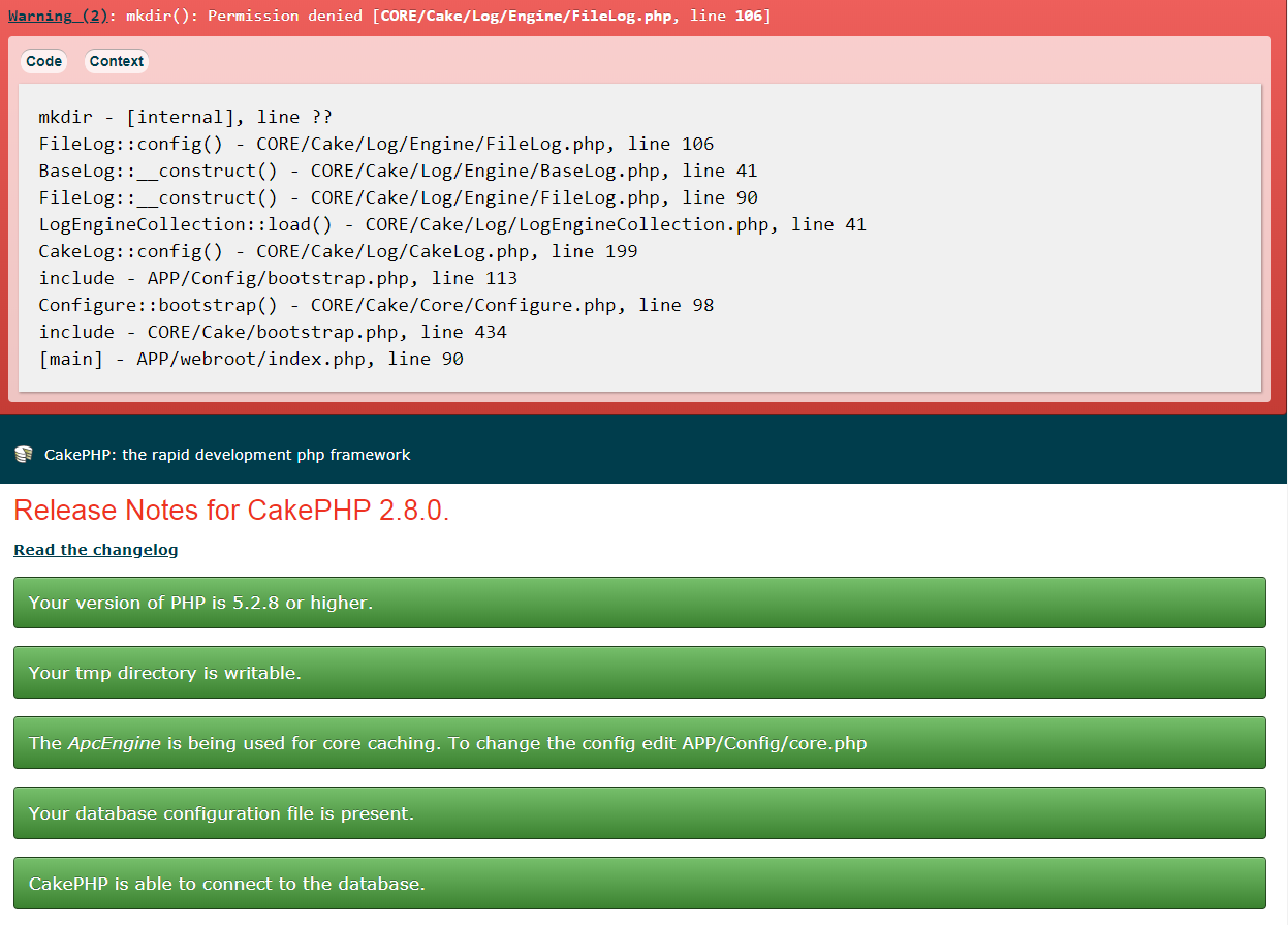

I am still having a permission issue with CakePHP as you can see from the below screenshot. I am not sure what permissions I need to change. Any thoughts?
Re: Zoneminder 1.30.4 API not working on FreeBSD
it is starting to look good. the error you are seeing I think, is from cakephp trying to write a log file in a folder someplace that does not have the permissions for www-data to write to it and so it does not exist. check that the directory the log file is writing to has the correct permissions and exists.
what does the URL /zm/api/host/getVersion.json do now?

When testing the APIs, by going to http://server/api/host/getVersion.json, I am still receiving a 404 Not found error. Again, because this is directly in a FreeNAS Jail, the /zm/ is not needed for the correct path. The path to my server is http://server/ without the added /zm/ directory
Looking at the api/app/Config/bootstrap.php, the paths you mentioned look to be mostly correct. But the file is a little different than what you have:
CakeLog::config('debug', array(
	'engine' => 'File',
	'types' => array('notice', 'info', 'debug'),
	'file' => 'cake_debug',
CakeLog::config('error', array(
	'engine' => 'File',
	'types' => array('warning', 'error', 'critical', 'alert', 'emergency'),
	'file' => 'cake_error',
CakeLog::config('custom_path', array(
    'engine' => 'File',
    'path' => '/var/log/zm'
I tried switching this to reflect yours but it seems to break everything. Switching it back corrected it, but I am still left with the mkdir permissions error from CakePHP. Looking at my Zoneminder installation it looks like the path above "/var/log/zm" is mostly correct, but I do not have a /zm/ directory inside of my "/var/log" directory.

I am very close on this. The mkdir CakePHP issue is the only thing that looks to be preventing the API from working. I am not sure if this is a permission error or an error in a config file. Any guidance would be greatly appreciated.
