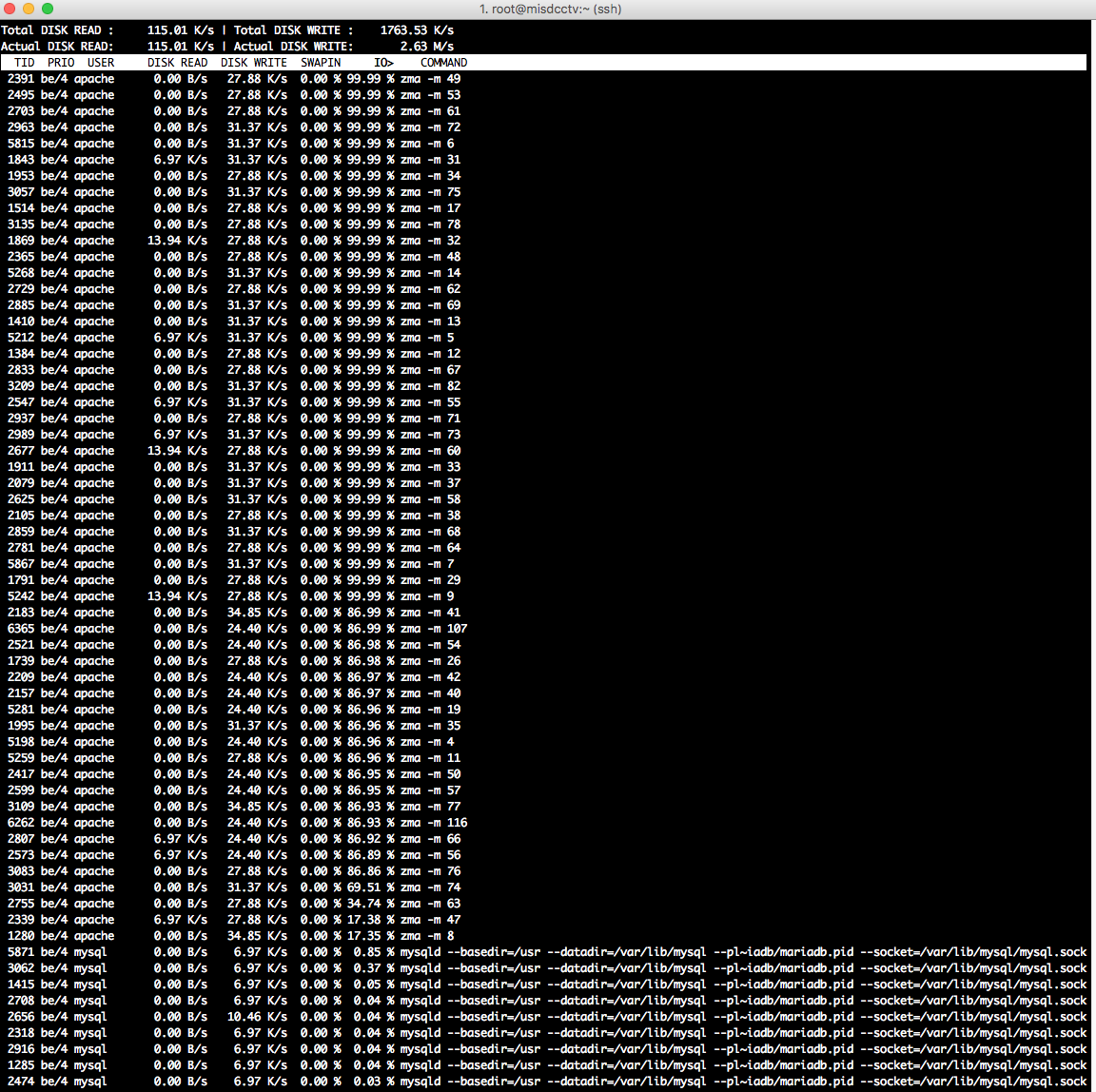

We are seeing extremely high load times and iowait times, sometime over 50 load average. There doesn't seem to be a lot of disk activity related to the wait time (see attached). I'm having a really hard time pinning this issue down. Here is our zm setup:

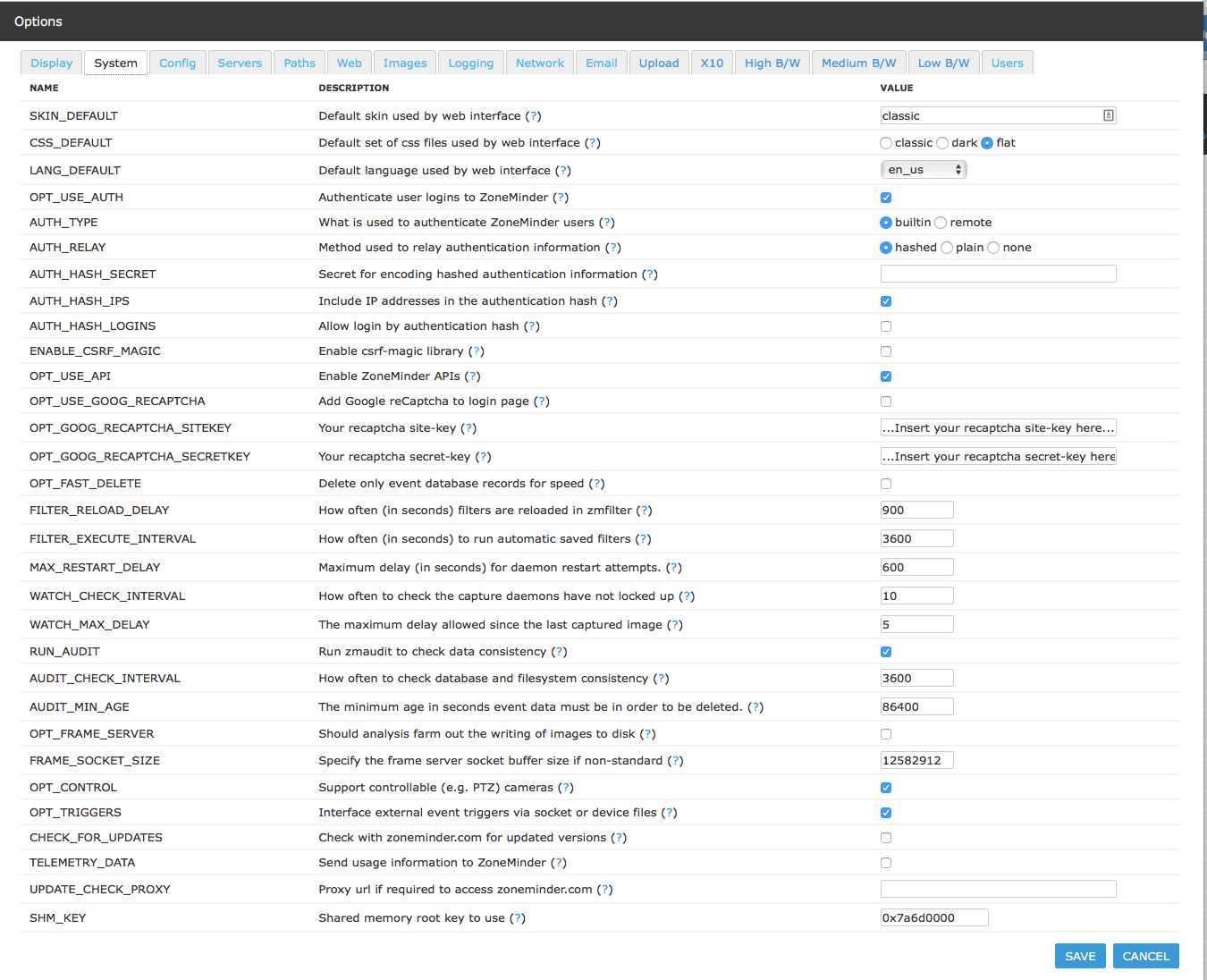

I've tried several configuration under options related to zmaudit and how often to run the filter and nothing seems to bring down the load.

top screen
top screen

iotop screen
iotop screen
Screen Shot 2017-04-19 at 11.21.11 AM.png (308.02 KiB) Viewed 2709 times
options screen
options screen
Screen Shot 2017-04-19 at 11.28.51 AM.png (300.12 KiB) Viewed 2709 times

Posts: 3403
Re: Extremely high iowait time & load
Ok, so you get that raid5 means that the write speed is that of 1 disk. So all the zma's are trying to write to your raid5 and are backed up.
