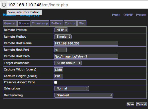

I have 4 of these AXIS M3104-LVE devices (support for these should at least be on the roadmap b/c apparently Comcast is using them now and there will be a ton of used ones on the market since their prices are high and their customer service is terrible...) and am unable to get video from them into ZM, although I have no issues connecting straight to them.
Screen grabs of my settings attached. Checking out ivideon (Update: requires desktop OS, and these are headless LXD containers, havent managed to get VNC working correctly on one yet) or Kerberos.io (lots of compiling since no LXC image available, only Docker and don't care to nest them.)
It should be noted that I have changed settings multiple times and followed multiple guides to no avail:
https://wiki.zoneminder.com/Axis#AXIS_M3007
https://wiki.zoneminder.com/How_to_setu ... _tilt_zoom
http://www.ispyconnect.com/man.aspx?n=Axis
As you can see from the screen shot attachment my Axis camera is still not usable. ZM is running as version 1.30.4 on Ubuntu 17.04 Xenial as a LXD container. I also had a Vivotek IP7330 POE camera hooked up but it was also bug riddled on ZM and it took about a week to find the correct settings.
Thanks.

spyderdyne
Joined: Mon Aug 28, 2017 4:02 pm
Re: Axis camera issues
Post by spyderdyne »
Anonymous seems to work, but HTTP auth is broken in this version or something...

You need to configure the Axis camera to accept "unencrypted/encrypted" passwords.

Henri
Posts: 29
Joined: Mon May 16, 2011 7:39 pm
Post by Henri »
Schultz wrote: Sun Oct 29, 2017 4:30 pm
Henri wrote: Tue Sep 12, 2017 9:51 am You need to configure the Axis camera to accept "unencrypted/encrypted" passwords.
How do you do that?
In the screen : System -- Users under HTTP/RTSP Password settings.
