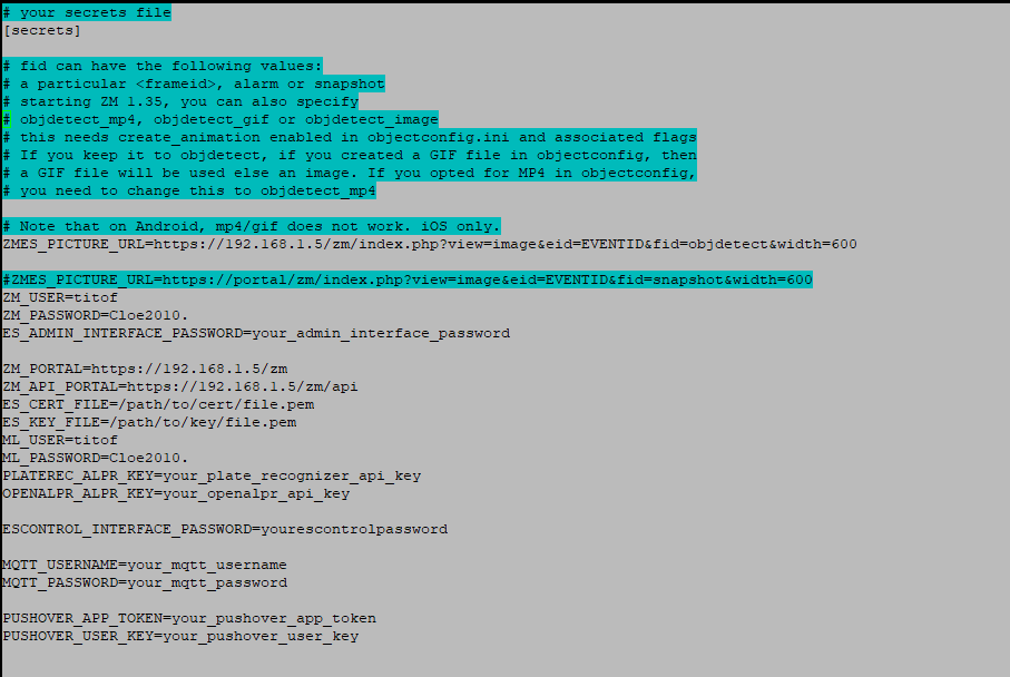

Do you have SSL certificates? And are the certificates in the /etc/apache2/ssl/ directory?
Did you fix the typing errors in secrets.ini?

tsp84 wrote: Wed Mar 17, 2021 8:49 pm Do you have SSL certificates? And are the certificates in the /etc/apache2/ssl/ directory?
yes, I corrected the typing time in secret.ini

Now you need to add those certificates to ES as well in the secretes.ini
ES_CERT_FILE=/etc/apache2/ssl/zoneminder.crt
ES_KEY_FILE=/etc/apache2/ssl/zoneminder.key

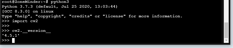

Also go into the python3 interpreter and try and import cv2
python3
once inside the interpreter it will say something like this ->
Python 3.8.5 (default, Jan 27 2021, 15:41:15)
[GCC 9.3.0] on linux
Type "help", "copyright", "credits" or "license" for more information.
then try importing cv2 and getting its version.
import cv2
cv2.__version__
Hit Ctrl+D to exit the python interpreter.
This is the output of when I import cv2 in the python3 interpreter ->
>>> import cv2
>>> cv2.__version__
'4.4.0'

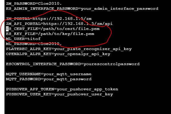

tsp84 wrote: Thu Mar 18, 2021 3:48 am Ok for the certificates if you get any certificate errors, which you shouldn't as they are globally readable, you would need to change ownership to www-data:www-data
sudo chown www-data:www-data /etc/apache2/ssl/zoneminder*
Are those self signed certificates for your zoneminder Internal LAN IP (192.168.1.5)? or certificates with a domain name?

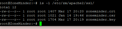

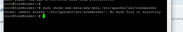

for me apache 2 and in the directory
etc / zm / apache2 and not as you say etc / apache2
tsp84
Posts: 227
Re: I am lost in the configuration of zmeventnotification
Post by tsp84 »
you forgot the * at the end of that command
titof2375
Posts: 66
Post by titof2375 »
instead of what I have surrounded?
I never put a domain name in the installation so I would say the ip

tsp84 wrote: Thu Mar 18, 2021 3:54 am Also go into the python3 interpreter and try and import cv2
python3
import cv2
cv2.__version__
>>> import cv2
>>> cv2.__version__
'4.4.0'
This is what I have on python
Post by tsp84 »
Yes change the surrounded / circled items to -->

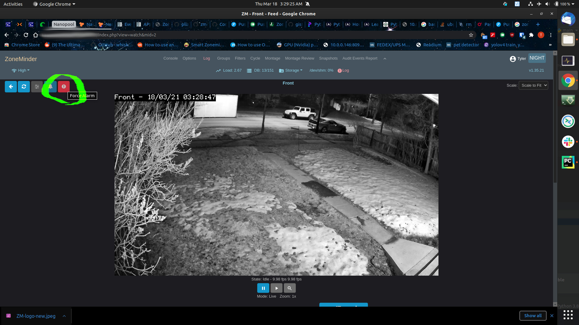

Next try and start the event server in debug mode
sudo -u www-data /usr/bin/zmeventnotification.pl --debug
and force an alarm to see what errors you get. You might have to turn off hooks for now to see if you can just get regular notifications for every alarm, then work your way up to object detection.
Here is the circled button to click in order to force an alarm. Make sure event server is running in debug mode and force an alarm then see what the debug outputs.
Screenshot from 2021-03-18 03-29-25.jpg (390 KiB) Viewed 12043 times

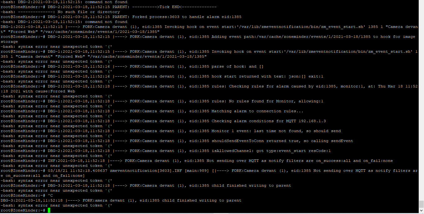

titof2375
Posts: 66
Post by titof2375 »
this is what I have
tsp84
Posts: 227
Post by tsp84 »
What command did you put in? I see every 2nd line bash is throwing an error for a ")".
At least it's finding and attempting to process events, so your on the right track.
